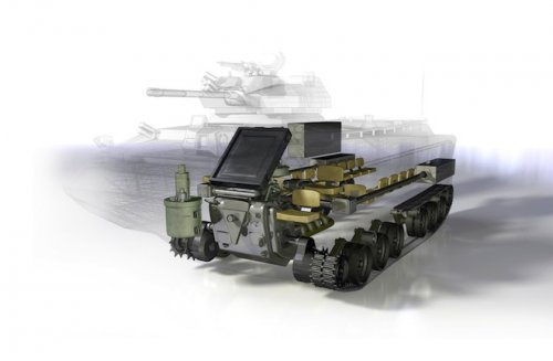

The winner of the first FANG challenge was the Ground Systems team.
The FANG Challenges
Mobility/Drivechain Challenge
Scope:
Utilized new open source design tools
Designed the drivetrain and mobility systems for an amphibious infantry fighting vehicle utilizing component model "building blocks"
Assembled the component models into a functional vehicle architecture
Integrated the functional architecture into the provided hull
Virtually tested the performance of the vehicle against requirements such as land speed, water speed, mobility, payload and manufacturability
Submitted the design for a score
