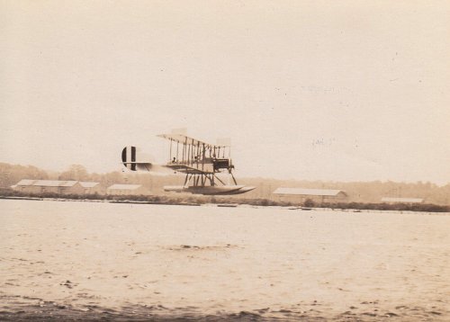

This aircraft is described as the PT-P. Commonly known as the Curtiss PT-2?
source: https://www.ebay.com/itm/253684413186
