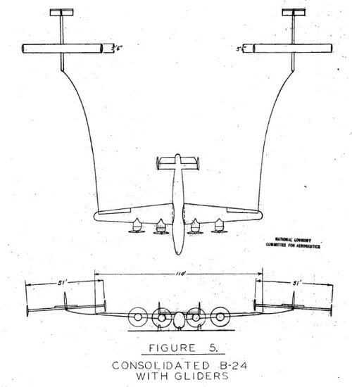

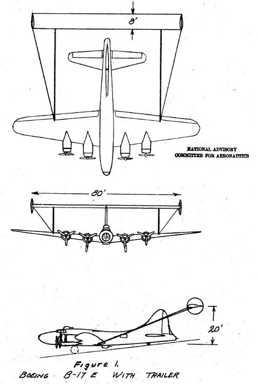

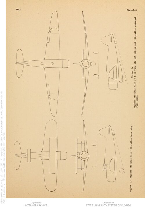

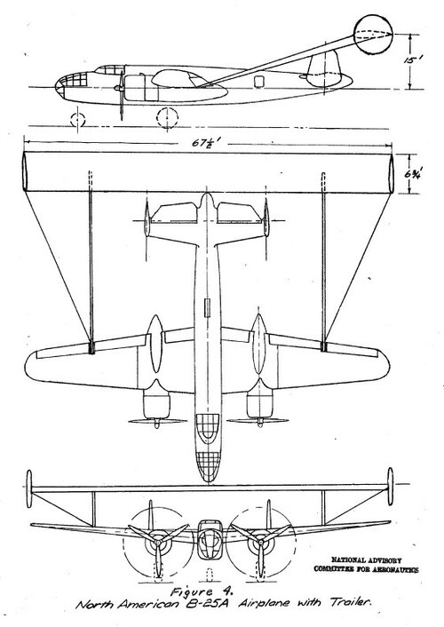

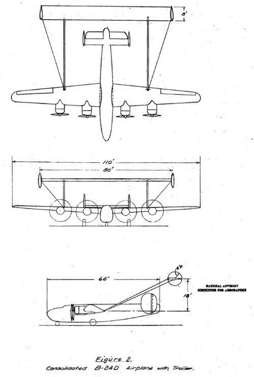

NACA 1942 report to extend the range of bombers
Temistocle
9 December 2009
207
419

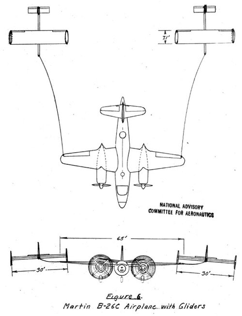

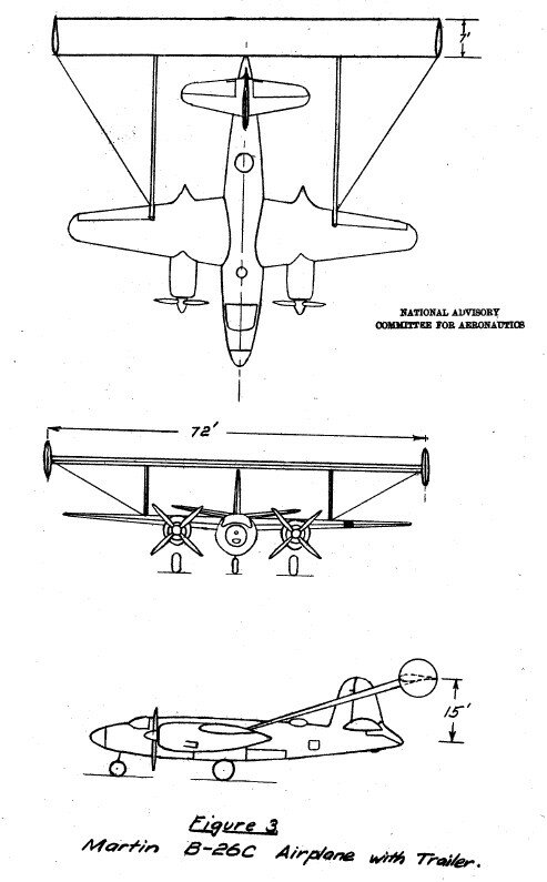

In 1942 NACA made a reasearch about extending the range of the AAF bombers using tank wing trailers and gliders. Here the figures of the proposals, taken form the following report.
  • Investigation of means for extending the range of several bombers to 6000 miles - 1942.pdf

Either it would have confused the hell out of LW pilots... or it would have turned the bombers into matches and flying bonfires.
Would've been useful for ferry flights from the continental US factories to European or Pacific airbases.
I reckon tanks in bomb bays would have worked better for ferrying, less drag.
