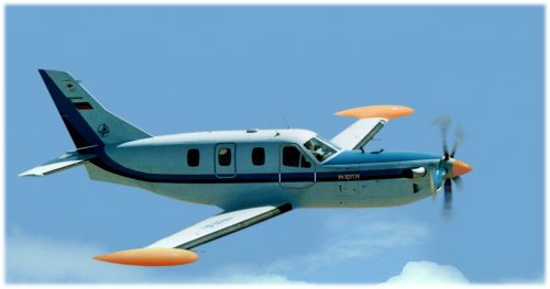

Picture of the M-101TM proposal:

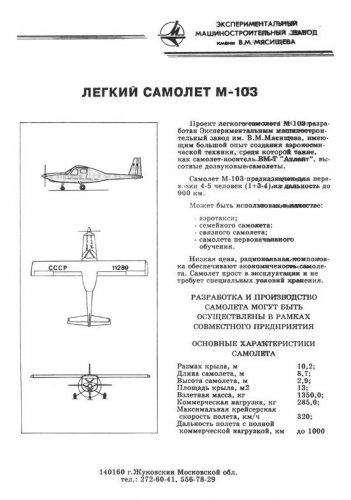

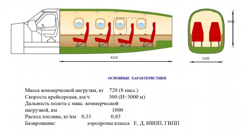

Pictures of the M-103 project:

Interesting that the aircraft depicted as the M-103 in my posts is actually the one called M-101TSKh in yours. A closer look actually shows the same M-101TSKh designation on it. But even then we can notice a difference between the model shown in the montages (with 3 cabin windows) and the inboard profile view (4 cabin windows).
As for the aircraft which you posted as the M-103 Skif, it is quite a different bird! Since the document looks older than the one I posted, it seems that the original M-103 was abandoned, and the designation reused for the M-101TSKh.

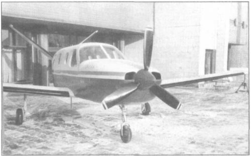

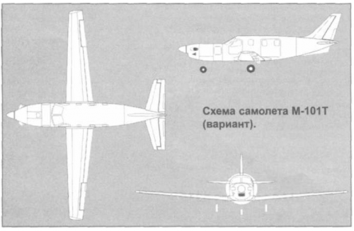

From Kryl'ya Rodine 1/2003,
here is a full scale mock-up to M-101 but with V-tail,the Model for wing tunnel and
a 3-view to M-101T.
