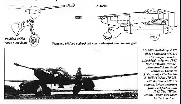

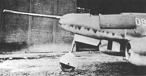

A correction to my previous post: I've been digging, and come up with a photo of the MK 114 sort-of installed in the nose of an Me 262. Probably not flown, as it was cancelled as overweight.

could you send the picture by PM at least?

Well spotted - I did wonder whether the caption was accurate, it is not unusual to find mis-identification in this field.
That takes me back to my original view that the MK 114 was at a very early development stage when (according to one source) it was cancelled in 1944 due to its excessive weight.
