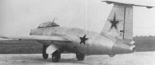

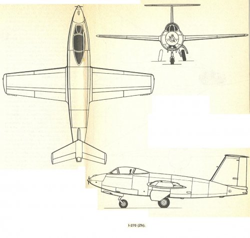

Also an early soviet rocket-propelled plane which seems to not be covered here yet:
the MiG I-270

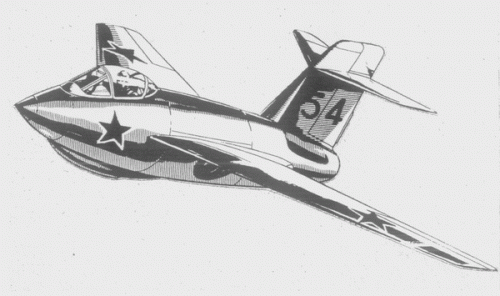

Found in InterAvia 7/1952, a "Jak 21" derived from the Me 163 (obviously !)
In 'Air Force -the magazine of Air Power' March 1955
the straight winged aircraft is discribed as a rocket powered fighter
and designated Yak-21 !!! (by the author of the article)
Other sources - Le Moniteur de L'Aeronautique :May 1979 speaks about
the aircraft as the Type 11..
"Jak-21" = Mikoyan/Guryevich I-270 = "USAF (Code) Type 11"
In 1947 the USAF decided to give a special type number to all unknown Soviet aircraft (without assignment to any OKB / Type 1 up to Type 40). This procedure ended in 1955 with introduction of the NATO code names. 'USAF Type 11' was Mikoyan I-270 in reality, often, but wrongly described as 'Yak-21' in Western publications.
Regards,
Thomas
Actually it's based on the un-built Me-163 replacement, the Ju-248 (which was supposed to have a longer range).
Kind of. The drawing combines the cut-down fuselage of the Me-163C/Ju-248 with the horizontal tail of the Mikoyan-Gurevich I-270 mentioned by boxkite. But, in the drawing, they got the I-170's tail position wrong and kept the swept wing of the Me-163/Ju-248. Quite a chimera ;D
BTW: the Me-263/Ju-248 V1 and V2 were built. They just weren't flown with rocket power.

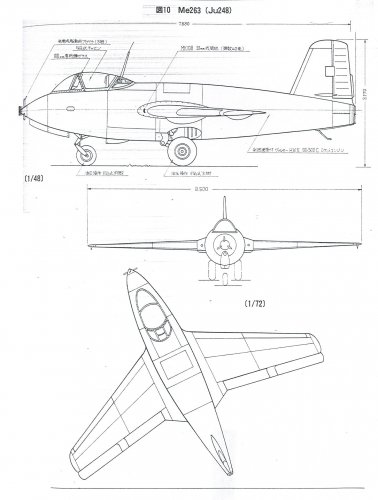

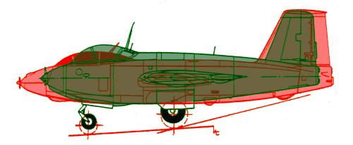

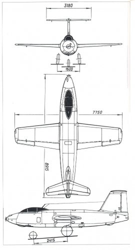

Very minor similarities, actually. Only in fuselage outlines which are really following function – simply cigar-shaped, without any “architectural extravagances”. Howewer, the 263 and I-270 fuselages are different in length, diameter, and even in shape: Me 263 had curvilinear “aerodynamic” outlines (kind of stretched drop), while I-270 had middle fuselage part cylindrical – like many later MiGs from 15 to 21.

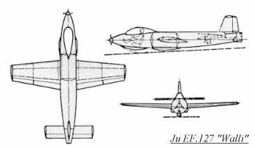

And which is more important – Me 263 and I-270 had totally different aerodynamic configuration. Even if they would have the same fuselage, they would be two different aircraft ;) ! But the real-world ones have very few common features (if any). They both are rocket-powered interceptor fighters with dual-chambered engines – beside this, all the rest was different! For example, Junkers EF-127 Walli project looked much more like I-270 than Me 263 (although it’s notably smaller and has only single-chamber rocket engine). But anybody never proclaimed that I-270 was inspired by EF-127 :) .
And:
1. Any reliable Russian source regarding I-270 (including those closely connected with MiG OKB) doesn’t say about any German inspirations;
2. Any reliable source doesn’t confirm that Me 263 or Ju 248 was ever captured by Russians, tested or studied in the USSR. There are neither photos, nor documents – unlike other German jetplanes which were actually tested or studied.
I made more detailed comparative analysis of Me 263 and I-270, their similarities and differences here: http://scalemodels.ru/modules/forum/viewtopic_p_262933.html#262933 (in Russian). Brief English version is here: http://www.secretprojects.co.uk/forum/index.php/topic,9055.msg82592.html#msg82592.

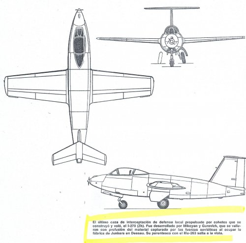

As per William Green "Warplanes of the Third Reich" pp 369 and "The Rocket Fighter" pp.153
The I.270 (Zh) was a development from the Me 263/Ju 248

OK Justo – now I know WHO bears responsibility for this *** myth! ;)
With all the respect for Mr. Green – he is definitely mistaken in this case.
I think Mr. Green wrote this many years ago. And, as I see, that time he had very vague conception of how the I-270 appeared and what it actually was. As his text shows, he really imagined I-270 as Me 263 with “alternative” wings ;D ! Is it true? You can make your own conclusion – just look at comparative pictures attached to my previous post!
Also Green shows his very limited knowledge of Soviet aviation history at all. He wrote that our designers were “dubious of the lack of horizontal tail surfaces”. For why? ??? In any way, our experience with tailless aircraft wasn’t less than German (of course you know about Boris Cheranovsky and his works?) At the same time when I-270 was designed and tested, at least two highly advanced projects of swept-wing tailless jet fighters were designed in the USSR – BICh-26 by Cheranovsky and “M” by Oleg Antonov. And the layout of Me 263, with its large, thick wing, definitely wasn’t so advanced. The I-270 layout with small, thin laminar wing is more progressive and more suitable for high speeds. Remember the World’s first aircraft breaking Mach 1 – the legendary Bell X-1: in layout it was a twin brother of I-270!
And, as I already noted, Green’s statement that Ju 248 prototype was captured in Dessau and sent to the USSR to become I-270 :) is more than doubtful. Anybody never had seen any Ju 248 / Me 263 photos with Red Stars, as well as documents regarding its studying or tests, until now. Dmitry Sobolev, a renowned Russian aviation historian, wrote a book: “German trace in Soviet aviation history”, strongly based on the research he made in archives. In this book there is detailed description: what was captured in Germany, in what quantity, and how all this was used. But any mentions of Ju 248 or Me 263!
Also Mr. Green make mistakes in the story of I-270 itself:
- I-270 wasn’t flown in 1946 – it rolled out from assembly shop only at December 28, and the first flight on tow was made at February 3, 1947 (pilot Viktor Yuganov);
- There were no several crashes” – only one, at September 2, 1947 (first flight of the 2nd prototype and the first “fire” flight at all), due to pilot's mistake in landing;
- The program was abandoned only in mid-1948 which isn’t “shortly afterwards” (to my mind).
William Green was a respected author of his day but he was writing in the Cold War. Information on Soviet designs at the time was patchy, often wrong, and laced together with lots of guesswork.
