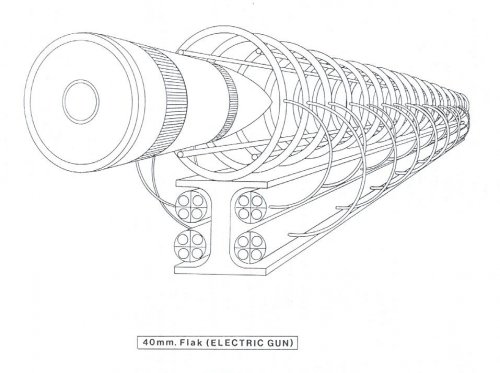

Plese see attached some text and drawing by myself

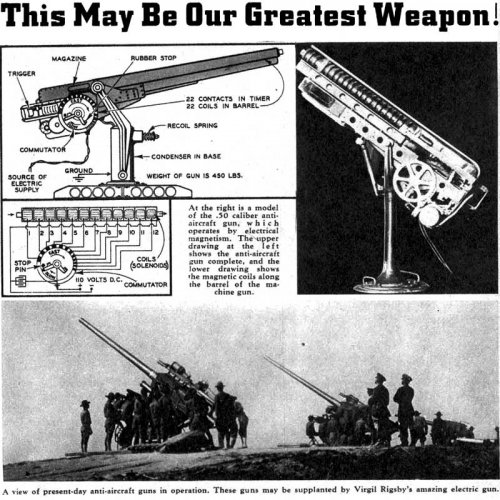

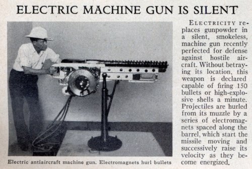

More on Rigsby's Coilgun.
