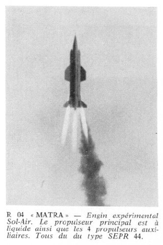

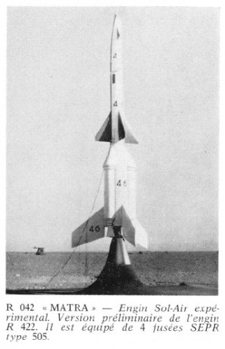

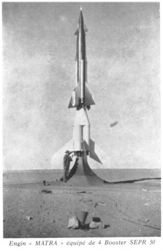

The third photo, supposed to show a R042, is actually a R422A. Its booster has 3 motors and not four as indicated.

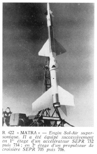

The last picture (Matra rocket) shows a R042. Note that its booster has four motors.
Note also the difference in diameter of the missiles: 60 cm for the R042 and 40 cm for the R422.
Note also that the R042's liquid engine was not ready, this experimental missile was powered by solid motors fixed all around.
