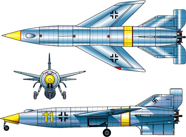

As to the rest of the bibliography, I'm sure I'm not alone in wanting to see original source drawings of WWII-era manned V-2s. I've personally only ever seen two... one showing a research vehicle with large wings and underslung ramjet, and the other being a crude sketch by WvB himself showing how to seat three in the nose of a V-2. I'll PM you my postal address.

The intention of this post is just to inform on the results to the question posted by Orionblamblam last December 2.
The research done since that date shows that none of the published drawings on the piloted A-9 were made during wartime. The oldest one I have was published by the French magazine "La Revue Aéronautique" in January 1946.
The abundant bibliography published on the subject does not prove (from a historical point of view) the existence of such a project and, consequently, all the drawings published on the piloted A-9 (mine included) must be considered as speculative illustrations, until a new documental testimony proves its rightness or error.
The origin of the issue is that the aim of the research in Peenemünde was the manufacturing of rockets that would do same work than the German Army artillery. If they were transformed in piloted machines, Göring would claim the whole project for the Luftwaffe.
This is the reason why, as von Braun declared after the war ("Project Satellite" by Allan Wingate, K.W. Garland Ed. London 1958) the designs existed in a clandestine way and there is a possibility that he himself transferred them to the USA at the time of the Paperclip project.
I asked Ron Miller and Jack Hagerty some years ago but they did not have any more information than I do.
