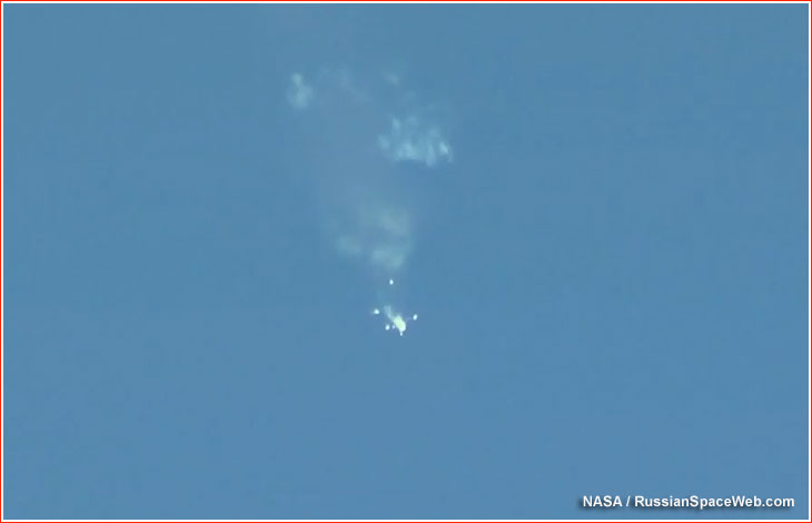

Here better Video
https://youtu.be/CnQlj73NIm4
Note at 2:20 mark
there something lighting up, follow by plume in exhaust then a cloud form, then booster and piece emerge out that cloud
That could indicate that one of Booster had engine malfunction seconds before jettison
http://www.russianspaceweb.com/soyuz-ms-10.html

Looking this Video
It seems that Trouble start with Jettisons of LES at 0:16-0:20
Follow of that dark cloud in rocket exhaust at 0:23
if i interpret it right three of booster (right/down/top) detach at 0:26
the Left Booster is not to see and white cloud form at 0:27
as Cloud dissolve at 0:34 you see seven piece, four of them are booster
the Core stage engine are not working, start to rotate on long axe
TomS
CLEARANCE: Top Secret
Apr 16, 2008
3,130
67
This fits with what has been disclosed. The tower jettison is scheduled for a few seconds before the first stage boosters (T+1.4 in the mission), so there's nothing abnormal until T+1.58 in the mission. (Some grey smoke may be related to throttling down the kerelox boosters cutting their oxygen supply at separation.) At that point, the Russians say one of the pyros that is supposed to separate the first stage boosters from the second stage core didn't function, so you had one booster still burning and strapped to the core at a single point. Booster then rotated into the core and that's the catastrophic failure we see.
The Soyuz LES has a couple of elements -- the tower jettisons just before staging to reduce weight for the second stage. At that point, rocket motors in the shroud are the main abort motors for getting the capsule away from the stack, and that's what functioned in this mission. The shroud goes away something like 40 seconds after the tower jettison and the Soyuz capsule is on its own at that point.
