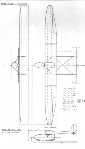

Well, Magni RR was in reality a project of Ettore Cattaneo, born in 1898 circa 10 km from my home... He was a physician and a pioneer of sailplanes. He made a type of powder rocket in the second half of the '20s and after the Von Opel experiments in Germany he worked with Magni Aviazione in Milan (Ing. Magni was very near to Caproni, and did several projects for them). They used the wing of a sailplane, the GP1, made by Magni and previously bought by Cattaneo himself. They did a new airframe with a rocket compartment housing rockets with a combined thrust of 300 KG and a double tauil. The wing was mounted high. Relevant data were: void weight 195 KG, maximum T/O weight 300 KG. Span 16,56 m, wing surface 26,64 sqm. RR stand for Radio Razzo (radio Rocket). The intended use of the plane was as a drone remotely piloted via radio. First flight was 28th June 1931. Ernst Udet was there as a correnspondent for Les Ailes.... The plane made six flights in all before being abandoned. Naturally I have a 3-view.... guess?

here is a small info about Magni RR aircraft.
Aeronautica Militare - La Propulsione a Reazione in Italia

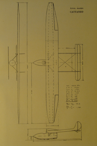

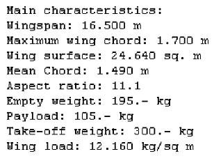

Also from;
http://www.avia-it.com/act/biblioteca/libri/PDF_Libri_By_AVIA/Annuario%20dell'Aeronautica%20italiana%201934.pdf
