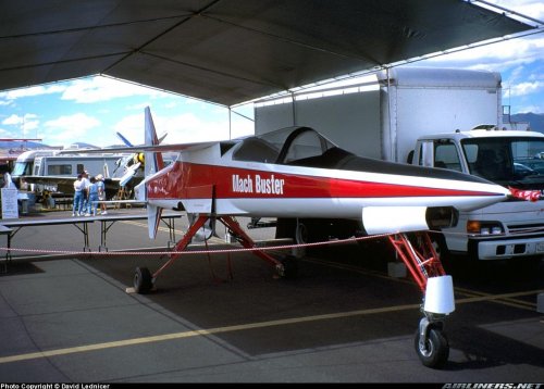

That picture looks like a static display piece.

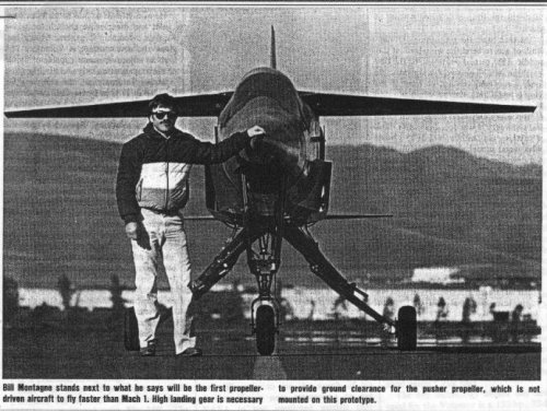

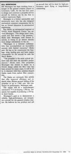

Registration N104MB has indeed been reserved for this prototype but has now expired. So it is not fake.,
http://registry.faa.gov/aircraftinquiry/NNum_Results.aspx?NNumbertxt=104MB
I found also the following docs (source AWST December 90 but first unkown (EAA magazine perhaps)) of the aircraft still in construction. Design is attributed to Bill Montage, not David Rose.

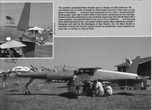

Why the Mach Buster... busted:
In 1999 David [Rose] bought Mach-Buster, a partially completed airplane whose design was based on high-speed aerodynamic research that had been performed at NASA Ames Research Center at Moffet Field, California. After considerable time and effort to finish Mach-Buster, David and his team determined the design was not suitable for flight testing and abandoned the project.
Source: https://www.eaa.org/en/eaa/eaa-chap...03-the-rest-of-the-story-david-roses-renegade

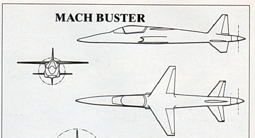

A friend recently gave me a collection of Aeroplane Monthly back issues. The December 1988 issue includes coverage of that year’s Oshkosh, where the Mach Buster was (first?) shown. A black and white version of the concept art earlier shared by Hesham is included, as is the following text:
A possible competitor to the Pond Racer at future air racing events is the Mach Buster, designed to become the world’s first propeller-driven aircraft to break the sound barrier in level flight. Similar in outward appearance to a Northrop F-5, it is fitted with a supercharged V8 racing engine which will power the aircraft through a scimitar-blades, high-speed propeller mounted behind the tail surfaces. The Mach Buster is now 80 per cent complete, and arrival of the airframe at Oshkosh created enormous interest. The team is confident that technology created for the propfan aeroengine can be successfully employed to run propellers efficiently at supersonic speeds. After a world record speed attempt, the Mach Buster will take part at Reno and other Unlimited-class air races. Skip Holme[sic], who has already won twice at Reno, will fly the aircraft and he is currently predicting average lap speeds of over 540 m.p.h. “It looks entirely possible to break the sound barrier coming down the straight leg towards the grandstands,” Holme said, “but it will be tough keeping in bounds on the 500 m.p.h. turns.”
