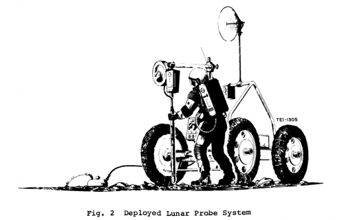

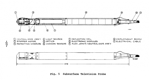

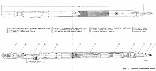

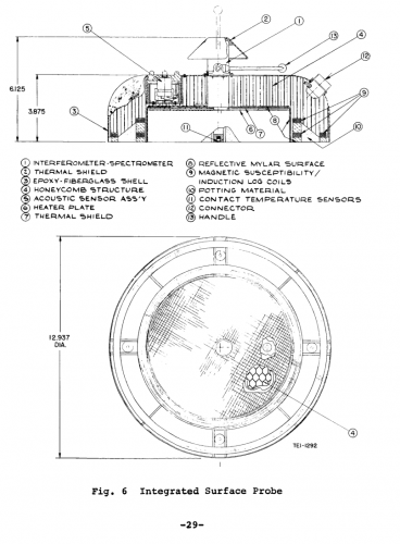

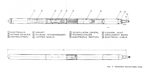

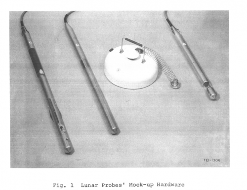

I was looking for information on the Lunar Surveying Staff, an instrument proposed for the first series of Apollo flights and stumbled across a report into the proposed lunar surveying instrumentation intended for the lunar flights carried out under Apollo Applications.
What is of interest (aside from the proposed instrumentation), is that it appears to be deployed from what is described as the LSSM, however the vehicle depicted seems to be an unpowered trailer.
Lunar Geophysical Surface & Subsuface Probes For Apollo Applications Program, Volume One. Detailed Technical Report
http://ntrs.nasa.gov/archive/nasa/casi.ntrs.nasa.gov/19670009582_1967009582.pdf

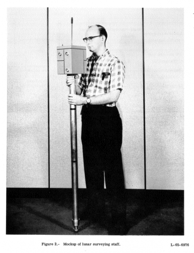

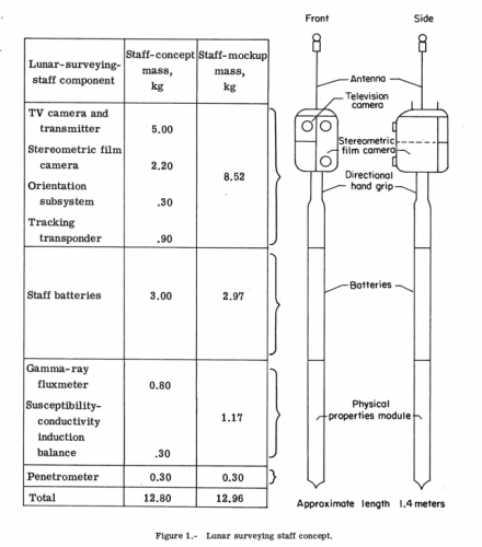

That is something I've always wondered myself, but I've found very little on the NTRS about proposed lunar survey instruments, although studies must have been carried out.
The unflown Lunar Surveying Staff is a case in point, there is only one document on the NTRS relating to it, the pictures inside indicate a clear relationship between it and the devices in the OP, but I've been unable to find out more.
Experimental study of the application of penetrometer technique to the lunar surveying staff concept
http://ntrs.nasa.gov/archive/nasa/casi.ntrs.nasa.gov/19670014490_1967014490.pdf
