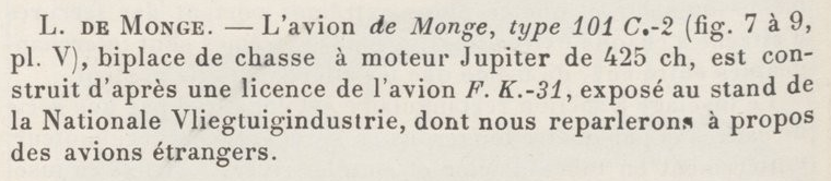

10.1 was a two-seat parasol wing monoplane fighter,a licence built Koolhoven F.K.31,1926

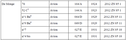

Also from Onera Archive,
there is two mysteries designs,and they were a BN.4,and each of them were from 1929 ?.

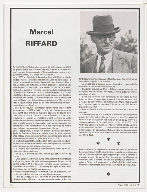

From Pegase,Unknown Project ?,
- At de Monge, in 1924, he designed a three-engined transatlantic
aircraft with a habitable wing. A flying model gives excellent results,
but the final device cannot be built due to the disappearance of the
firm.

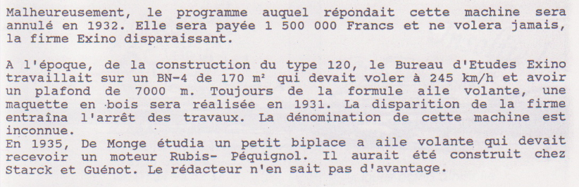

Even from TU 171 magazine,
unfortunately, the program that this machine responded to will be
canceled in 1932. It will be paid 1,500,000 Francs and will never fly,
the Exino firm disappearing.
At the time, when the type 120 was built, the Exino Design Office
was working on a 170 m BN-4 which was supposed to fly at 245 km/h
and have a ceiling of 7000 m. Still of the flying wing formula, a
wooden model will be produced in 1931. The disappearance of the
firm resulted in the work being stopped. The name of this machine is
unknown.
In 1935 De Monge studied a small two-seater with a flying wing which
was to receive a Rubis-Péquignol engine. It would have been built at
Starck and Guénot. The editor does not know more.

transatlantic flying wing passenger transport that progressed to the flying
model stage.
