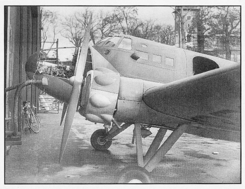

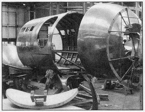

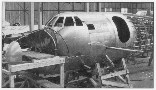

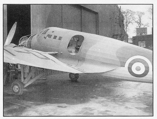

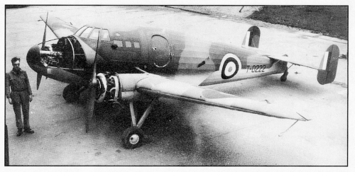

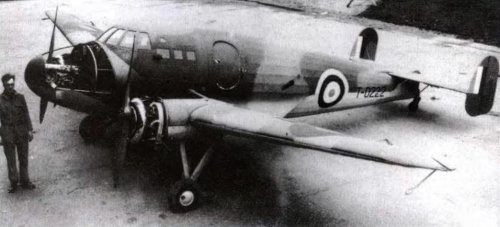

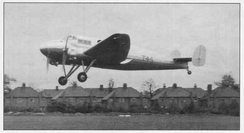

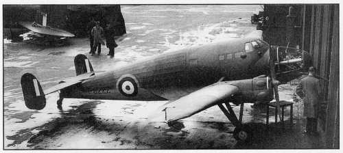

From 'Aeroplane Monthly ' December 1990, pp.734-737.
1,2 the GAL 41 under construction. Note in the first image the cabin door and door frame on the floor.

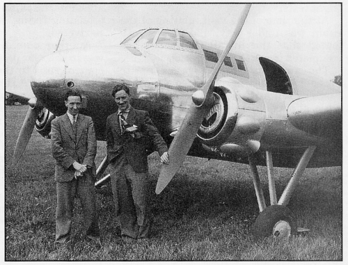

3, The GAL 41 ready for it's first flight. the designer is the gentleman on the right.
4, the GAL 41 making it's first take off. Colour is natural metal and silver dope, with class 'B' marking T45.

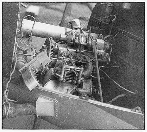

5, 6, 7, 8, The GAL 41 in camoflage and RAF markings, carrying the identity 'T-0222'. Note that the nose cowling is removed, showing the cabin blower and auxiliary blowing engine.

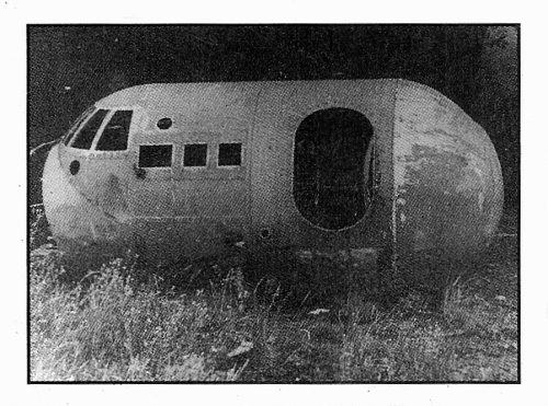

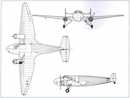

9, A close-up of the GAL 41 cabin blower and engine.
10, the GAL 41 pressure cabin lying derelict after the war.

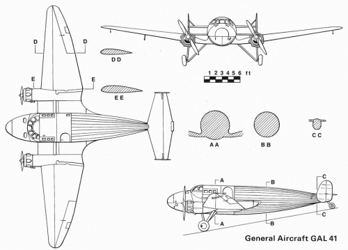

11, A 3-view of the GAL 41.
cheers,
Robin.

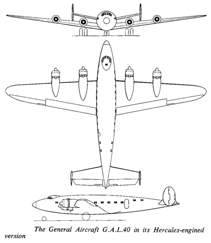

Responding to S.15/38, General Aircraft proposed the GAL.40, an advanced, four engined airliner with constant speed propellers, fowler flaps, and a tricycle undercarriage. Two versions were proposed, the GAL.40, with four Hercules, and the GAL.40A, with Merlins.
