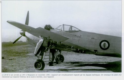

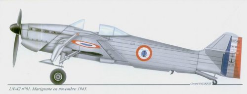

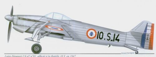

In the Aviation Francais Magazine N° 8 was an article about the LN-42,
here a 3-view, a photo and to colour profiles.

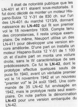

Of course my dear Jemiba and Skyblazer,
and here is the paragraph.
