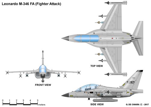

I suspect he question was actually whether there are airframe changes from the M-346 Master trainer to the new M-346 FA. The answer to that appears to be "no", aide from the radome and possibly some hardpoint changes. (The number of hardpoints on the M-346 is variously cited as five, seven, or nine. The FA seems to have settled on seven.)
The M-346 has five (one fuselage, 4 underwing) and the M-346FA has two extras on the wingtip. Wingtip hardpoints are for AAMs, notably AIM-9L which has definitely been trialed and IRIS-T which I'm not sure about (but which they definitely intend to integrate).
Also, to comment briefly on the external differences between M-346 and the Yak-130, the Yak-130 was certainly the starting point but Aermacchi did make substantive aerodynamic changes:
The wing was moved up the fuselage, having been too low on the Yak-130 and causing horizontal stabiliser blanking at mid to high angle of attack (AoA). The leading-edge extensions (LEX) were reduced and redesigned to give controllable vortex lift. Two small vertical fins were added at the wing roots to "trap" and control the LEX vortices at AoAs from 25-30° upwards. These LEX vortex controllers ensure the "vortex burst" over the wing at high AoA is symmetrical and controllable.
You can observe these changes on the aircraft quite easily, especially those vertical fins. Quite interesting stuff.
