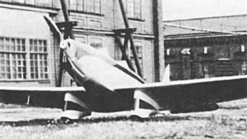

I know that,there was a Polish design has some Info about this mystery aircraft.
I check from many old encyclopedias,but no way.
Bonjour Hesham
From "airwar.ru.org"
Nothing more !!I don't understand

Hesham: As toura says, LKOD (Liepajas Kara Ostas Darbnica) is the maker's name, KOD-4 is the designation.
http://www.airwar.ru/enc/law1/kod4.html
The photo shows a low-winged cantilever monoplane with tandem, open cockpits, spatted main undercarriage, and an inline 4-cylinder engine (?? DH Gipsy Major ??) with tractor propeller.
http://www.airwar.ru/image/i/law1/kod4-i.jpg
"Developer: KOD
Country: Latvia
First flight: 1938
Type: Light multipurpose aircraft
KOD-4 - a light multi-purpose aircraft, developed by the Latvian designer A.Strazdinshom. Built in the workshops of Liepaja Military Port (Kara Ostas Darbnicas, all there was produced 20 aircraft type 5) in 1938 as the "people's plane".
Model KOD-4
Wingspan - 7.20 m
Length - 5.40 m
Height - 2.20 m
Wing area - 6.80 m2
Weight - empty 320 kg, MTOW 440 kg
Engine - 1 x 60 hp
Maximum speed - 160 km/h
Practical range - 320 km
Practical ceiling - 2,800 m
Crew - 2"

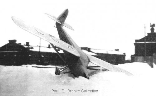

another KOD 3...ACCIDENT !
But I don't remenber where I've fond it
