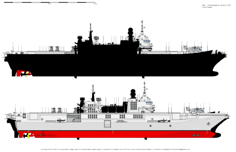

The two ships has similiar dimension, somewhat longer the Cavour while somewhat larger the Trieste as also heavier (33.000 ton vs 27.900 ton).
Cavour has an hangar of 2.500 sqm while the Trieste has one of 2.300 sqm.
^ thanks! sounds like Trieste is basically Cavour with one extra floor, for the landing dock stuff.
