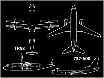

I can see how Karem could claim to be using differential prop for yaw control...not sure how he would address pitch with the tiny tail though....
Cyclic blade control?
I suppose the easiest solution would be to swivel the nacelles to point the thrust vector though, the mechanism is there anyway.
I think that the thrust vector passes very close to the longitudinal location of the cg, giving very limited moment arm. I'm still puzzled...
Yes, that's a point :-\ Looks like cyclic would be more appropriate for pitch control after all, despite the added complexity (and associated failure modes).
