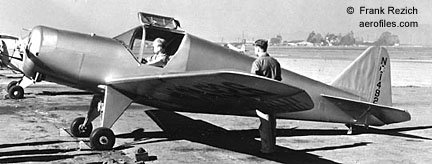

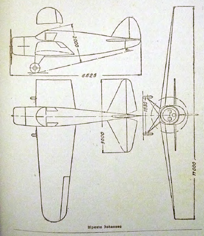

Thanks Hesham. That Johansen JA-2 (c/n 201, NC14926) engine was a Church Marathon J-3 air-cooled inline 4-cylinder -- with a power rating up to 46.5 hp. The Marathon J-3 was a larger-capacity development of the Heath-Henderson B-4 motorcycle engine (the Marathon J-3 being enlarged to 1.77 L capacity vs the B-4's 1.4 L).
According to Jack Erickson, the JA-3 was offered with a 40 hp Continental A-40-5 horizontally-opposed 4-cylinder. No mention of a 65 hp Lycoming.
http://www.enginehistory.org/HOAE/Continental1.html
Thank you my dear Apophenia,
but they wrote that,please see.

Thanks Hesham. My comment wasn't a challenge ... I just meant that Jack Erickson hadn't mention the JA-3 under his Lycoming listings.
Alright my dear Apophenia,
I just wanted to explain,and I think JA-3 remained a Project ?.
