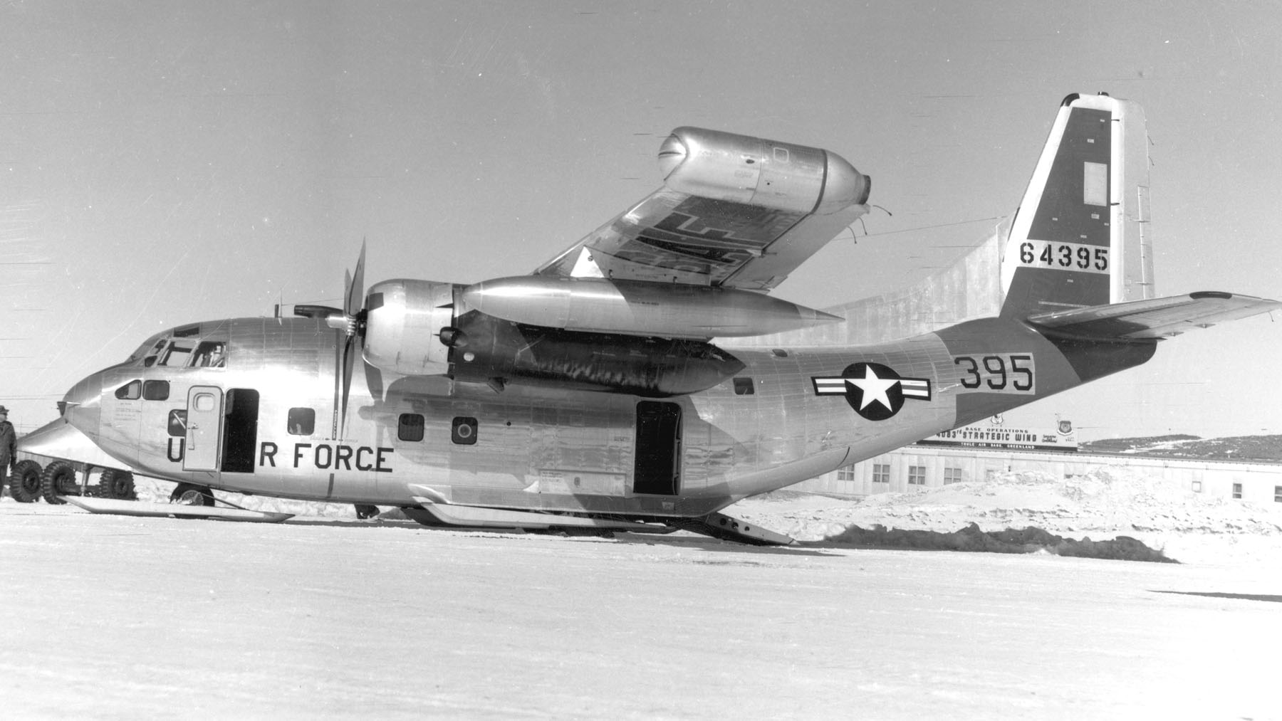

Does anyone have info about this one, the Fairchild C-123J. On the wingtips are J44 jet engines.

"Does anyone have info about this one, the Fairchild C-123J. On the wingtips are J44 jet engines."
In 1955 the prototype C-123B was fitted experimentally with two Fairchild J44 turbojet engines mounted at the wingtips to provide auxiliary power for use in an emergency. As a result ten production aircraft were modified into C-123J with turbojet engines fitted.
http://aviastar.org/air/usa/fair_provider.php
Ten C-123Bs were fitted with two Fairchild J44 turbojets, with about 4.45 kN (450 kgp / 1,000 lbf) thrust each, one mounted on each wingtip; they were also fitted with neat retractable ski landing gear, to be given the new designation of "C-123J", and used for service in Arctic regions. The US Federal Aviation Administration also used two Providers similarly fitted with Continental J69 turbojets on the wingtips, the J69 being derived from the French Turbomeca Marbore turbojet. These two machines were used in Arctic regions as well; it is not clear if they had any special designation.
http://www.airvectors.net/avboxcar.html#m4

For the C-123 and Noratlas and many other transports, it was to help at liftoff, not to get faster by any way. Transports don't really care about speed. Piston-powered transport aircrafts were underpowered, and when flying in very hot climates as in Algeria (Noratlas) or Vietnam (C-123) then their performances took a major hit. Jets pods helped getting safer liftoff. The pilots then shut the jets, otherwise they would have cut into the range, being so thirsty.

Since I'm guilty in the first place... Well, mixed propulsion mean piston engine and jet engine within the same airframe. The fact that they do not burn the same fuel is important because it means separate tanks and fuel systems. Which can be a nuisance.
I wonder how they handled that on, for example, the C-123. I suppose it had avgas tanks in the wings, for its piston engines. Then when they added the engine pods, they evidently need to store the kerosene somewhere in the airframe. I mean, can you fill an avgas tank with kerosene, just like this ? Or does it need some modifications ?
Aha, I understand what you ment now. I doubt that they replaced or modified an avgas tank to kerosene, because it wouldnt make sense to reduce the range of the airplane by, lets say half an hour, to allow those wingtip jets to run maybe 3 minutes?
Well, there was a trade.
Let's suppose a Noratlas transport flying in Algeria, said in 1959. Temperature on the ground is around 45°C. Yet the Nortlas is heavily loaded - because this is the Algerian war.
At ordinary temperatures- let's say, 22°C - a fully loaded Noratlas is already seriously underpowered.
Now the hotter the temperature, the longer, and more dangerous, the lift-off, because very hot air degrades both engine power and wing lift.
By this point, if the Noratlas crew is forced to liftoff fully loaded, and with such temperature, either their risk a crash, or either they light the wingtip jets to help liftoff, even at the expense of range.
in a nutshell: better to have a safe takeoff and a shorter range, rather than risking lives trying to get an overloaded, underpowered aircraft off the ground in a very hot temperature. Same for C-123s in Vietnam.
In fact a lot of very large, very heavy transport aircrafts that were piston-powered got jet pods to help liftoff. It is because turboprops were not ready yet.
When ones compare a Noratlas and a Transall, they are pretty similar in weight and overall dimensions and payload, more or less 10 mt. But their engine power is not the same. A Noratlas had two 2200 hp radials, so 4500 hp. A Transall has a pair of Tyne turboprops, 5500 hp each, total 11 000 hp, nearly three times more. The jet pods were there to help those big piston engine transport at lift-off. Then they vanished for the next generation of transports.
