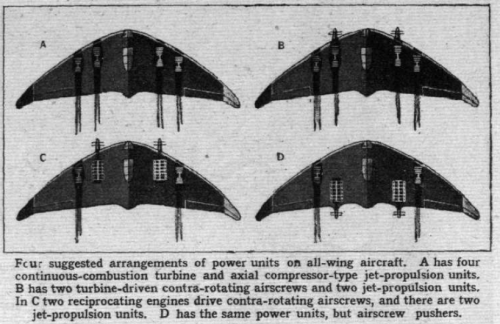

Thank you Steelpillow,
and we spoke about those designs before,but I found a comment,mentioned the Dunne
idea for a tailless concept,imaged by R.E. Poulton.
https://www.flightglobal.com/pdfarchive/view/1943/1943%20-%201228.html
https://www.flightglobal.com/pdfarchive/view/1943/1943%20-%201229.html

The 14th November 1941 edition of The Aeroplane included an article entitled ‘Tailless Evolution’ of which about half the text is Dunne’s account of his early flights, originally written in 1933. I would suggest that the correspondence between Dunne and Masefield (just a journalist in the technical department at this date, not editor) was probably initiated while the article was being prepared.
C.G.Grey had a letter published in the 28th November edition querying the claim for flights of the D4 in 1908 made by the (unnamed) author of the article, and the editor wrote asking for further details from readers. There is nothing in the correspondence page of any of the following editions to suggest that Dunne replied.
There are also two follow-up articles in the 8th December edition, one for and the other against the benefits of tailless aircraft.
Dunne certainly wrote on 2 December, to comment on some mistakes made by Grey. I intend to go and have a read through the relevant back numbers at some point. Perhaps Masefield was a sub-editor or Dunne was mistaken.
What was Dunne's account "originally written in 1933"? His standard account was written in 1913. Was it originally published in The Aeroplane or elsewhere?
