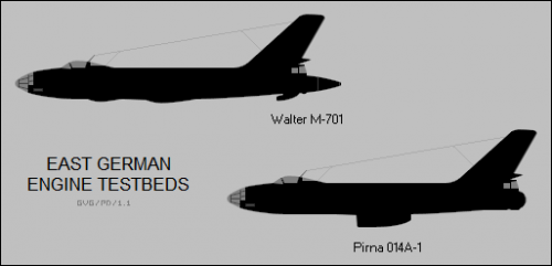

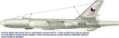

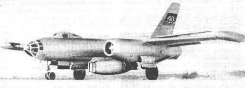

Hi!
http://wp.scn.ru/ru/ww3/f/10/4/0
"The flying Laboratory for the M-701 engine test. The aircraft was also used to test different configurations of brake-parachute containers. The engine under test had a special separate intake."

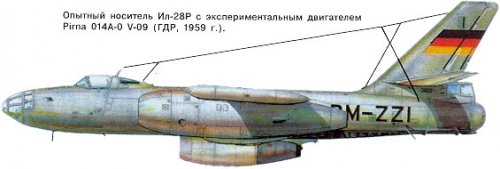

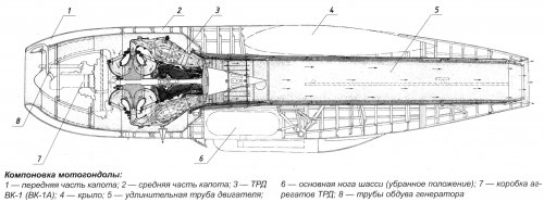

Hi!
http://aviadejavu.ru/Site/Crafts/Craft22318.htm
Former flying laboratory for turbojet "014"
And main engine layout.

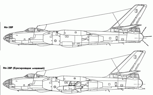

Il-28P scout.
http://www.airwar.ru/enc/spy/il28r.html

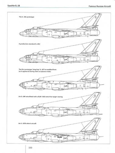

Ilyushin Il-28
Published: May 14th, 2016 Aircraft Publications
Author: Yefim Gordon and Dmitriy Komissarov

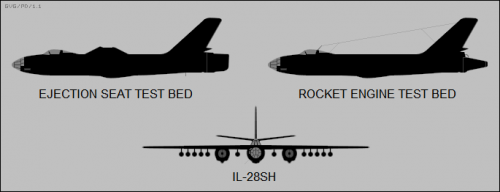

http://web.ipmsusa3.org/content/ilyushin-il-28
http://www.airvectors.net/avil28.html
