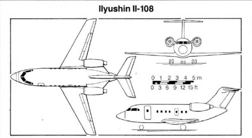

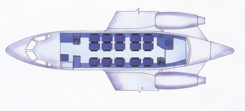

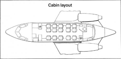

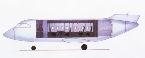

the Ilyushin IL-108 was twin engined business jet aircraft project and
powered by Lotarev DV-2s,it can carry 15 passengers as commuter
aircraft or 9 as executive aircraft.
http://www.flightglobal.com/PDFArchive/View/1990/1990%20-%201314.html

In the FLIGHT International article that hesham took the pics from (9-15 May 1990), we can read that "the design will be offered as either a nine-seat executive aircraft or a a 15-passenger commuter." So perhaps these weren't such radically different designs as you thought?

From Lambert, Mark ed. Jane's All the World's Aircraft 1992-1993 Jane's Information Group Ltd. 1992 p. 207.
Ilyushin Il-108
Type: Twin-turbofan business or third-level airline transport.
Programne: First shown in model form 1990, at initial design stage.
Design features: Conventional low-wing/T-tail configuration, with rear-mounted engines; wings and tail unit swept; winglets added late 1990; retractable tricycle landing gear with twin wheels on each unit. Manual flying contorls.
Power plant: Two ZMDB/Zaporozhye/ZVL DV-2 turbofans, each 21.58 kN (4,852 lb st.)
Accommodation: Proposed in two versions: (1) two crew and nine passengers, with facilities for work or relaxation on long flights. (2) 15 passengers, three-abreast with 40 cm (15.75 in) aisle; both versions with toilet, wardrobes, front and rear baggage compartments.
Dimensions external
Wing span: 15.00 m (46 ft 2.5 in)
Length overall: 15.85 m (52 ft 0 in)
Fuselage length: 14.00 m (45 ft 11.25 in)
Fuselage max diameter: 2.35 m (7 ft 8.5 in)
Height overall: 5.50 m (18 ft .05 in)
Tailplane span: 5.29 m (17 ft 4.25 in)
Wheel track: 3.00 m (9 ft 10.25 in)
Weights and loadings
Max payload: 1,500 kg (3,306 lb)
Max T-O weight: 14,300 kg (31,525 lb)
Max power handling: 331.3 kg/kN (3.15 lb/lb st)
Performance (estimated)
Econ cruising speed at 12,000 m (39,370 ft): 432 knots (800 km/h; 497 mph)
Balance T-O runway length: 1,800 m (5,905 ft)
Range at econ cruising speed:
with max payload 2,429 nm (4,500 km;2.796 miles)
with 15 passengers and max fuel: 2,615 nm (4,850 km;3,010 miles)
with nine passengers 3,235 nm (6,000 km;3,725 miles)
A second version was planned to be equipped with Lotarev DV-22 turbofan derivatives having a bypass ratio of 5 and a 35kN thrust.

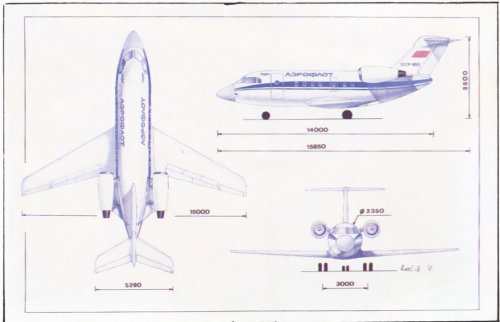

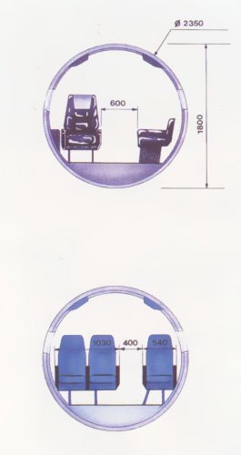

Here's some drawings and low res page scan from Yugoslav magazine Aerosvet International Issue 2.
