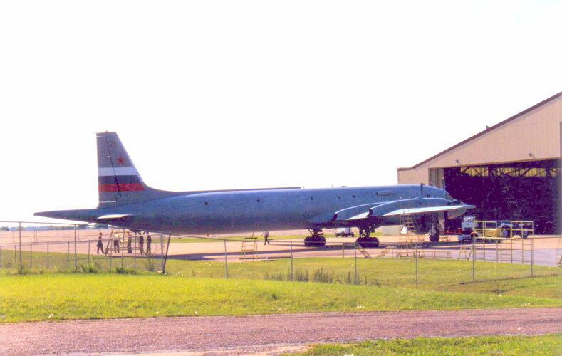

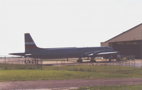

Page 15 "71 red" Il-38 seen at Sherman, TX in 1995 .
and a photo from :
http://forum.keypublishing.com/showthread.php?t=94228
As The Aviationist referred back to the IL-38 used in a film with US insignia to simulate a P-3, it jogged my memory that I never resolved why the IL-38 71-RED was at Sherman-Grayson, TX in 1995. I don't think Open Skies is the reason.
My friend who took the photo said
...wandering around Texas on 27 April 1995 heading up to Oklahoma called in at Sherman-Grayson to catch up with the Express One Maintenance facility and look at a load of stored airliners on the field. Found an IL38 May sitting outside an unmarked hanger. Coded Red 71. As it was late in the day, and the sun was behind the aircraft we went into the hanger to ask if we could take photographs from airside where the sun was on the aircraft. (In hindsight not the best thing maybe) We were told by three guys, none of which could hold there left arm by their side, No and we were trespassing and should leave immediately. However we did take some photos from the road, which of course is public land...
The aircraft appears to be back in Russia now so it can't have been appropriated for Foreign Materiel Exploitation or the like
According to another friend ....at the time although it had Russian Navy titles it was apparently operated by an organisation called 'OAO NIIS'. No idea who they are or what they do. The Open Skies function in Russia is assigned to the Air Force so it wouldn't have been carried out by a Navy MarPat/ASW aircraft, and as you say the aircraft involved always carry 'Open Skies' titles anyway.
71 red has been stored at St.Petersburg/Pushkin since at least 2007, still present in October last year and parked with 77 red right next to the ARZ20 hangar used for Il-18 family rework. It is c/n 082011207 and the 7x red sequence of codes in recent times has been used by 289 OSAP based at Nikolaevka. 77 red is due for upgrade to Il-38N so it could be that 71 red will be next.
If anyone out there knows why the aircraft was in Texas in 1995, I'd be delighted to know!
