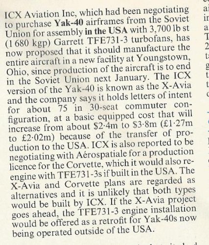

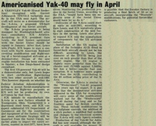

In late-1978, plans came to the attention of the press in relation a proposed new project that would see the Yakovlev Yak-40 being built in the US by a new company known as ICX Aviation. The ICX Aviation model would be known as the X-Avia, and would feature Garrett TFE731-3 turbofans in place of the original Soviet engines. Later plans revealed in Flight Intl (https://www.flightglobal.com/pdfarchive/view/1978/1978%20-%203395.html?search=yak-40) stated that avionics would be also sourced from Western Manufacturers. I attach copies of the Air International brief report from the September 1978 edition, as well as the Flight International report as mentioned above, from the 30 December 1978 edition. As far as known, this remained a paper project only, unless anyone knows further info.

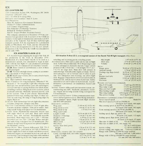

Just found more information on this fascinating project via a White House (!) paper. Pages 22-26 of the attached document.
  • The X-Avia was the development name. The production name would have been LC-3.
  • Besides Youngstown, Niagara Falls was considered a potential production site (it's treated in this proposal as the definitive one).
