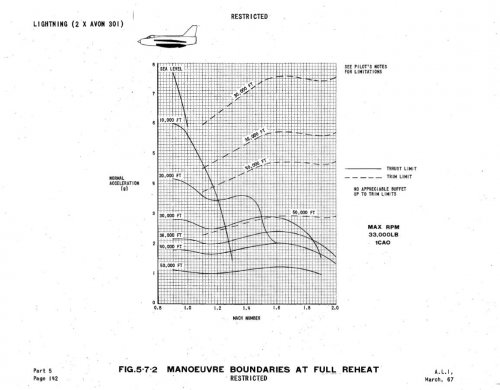

How to read this Lightning Manoeuvre Boundaries?

The "Thrust Limit" means steady turn loading factor (SEP=0) and the "Trim Limit" means the maximum turn loading factor?
Does it mean that Lightning F.6 got an even higher 'G' limit than F-86F?
I'm not sure about it. Plz help me.

Trim limit is probably the maximum useable lift coefficient. For all the altitudes stated the aircraft is lift limited rather than g limited. At lower altitudes it will become g limited.
