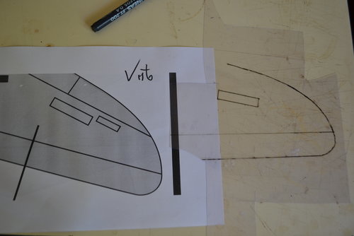

Hello :) im new here, and im about to finish this ho229, anyone had tips about how to fly this airplane? anything will be apreccited...i had fly zagi wings which are similar but tips for this one are not worthless :) just don`t want to crash it ahaha

i understand, i was watching the horten schematics yesterday night and they have small spoilers near the tips...i will build them and put them in the right place...i wil make them work in different channels in the radio acting "as a tail" in the radio , so i can control the yaw, :) and yes the 229trainer is a good idea!!
