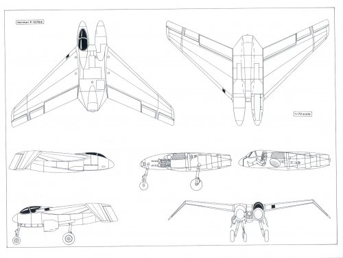

Could be of some help ?
http://www.luft46.com/images/1078b-2.jpg
Flitzer: Best of luck to your friend. I look forward to seeing his product(s).
Hi Flitzer,
look also here:
http://ww2drawings.jexiste.fr/Files/2-Airplanes/Axis/1-Germany/01-Fighters/He-P1078/He-P1078.04B.htm

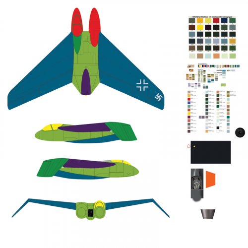

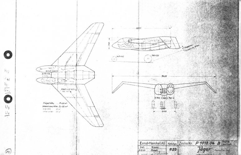

Progress report attached. Template layers in position.

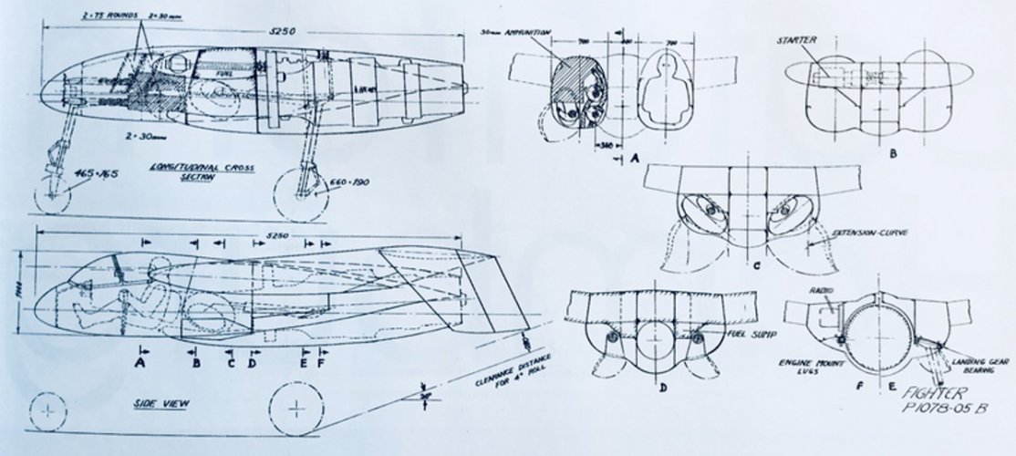

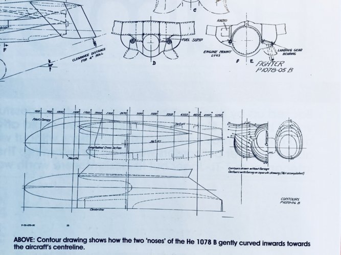

:-\I have a question please.
Should the noses be, for want of a better word, asymmetrical?
i.e. each being flared from the inside to the outside, offering a greater area of space in front of the central intake?
I've seen both the asymmetrical layout and more 'normal' examples?
Many thanks
P ;D
