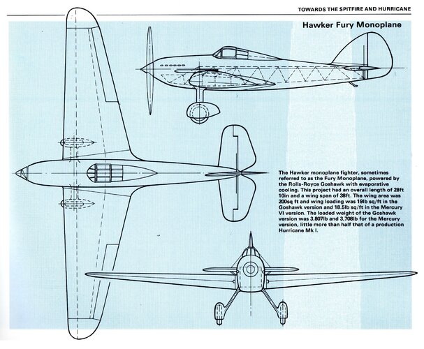

The Fury Monoplane could potentially have been quite a leap forward for its day. For comparison, the Miles M.20 stopgap fighter prototype of 1940 was a compromise design using as many Miles M.9 Master advanced trainer parts as possible and fixed gear to simplify construction. The result was a fighter midway between the Hurricane and the Spitfire in terms of performance with exactly the same engine, but with twice the fuel and twice the ammunition thanks to the weight saved and the volume made available in the wings by the fixed gear.

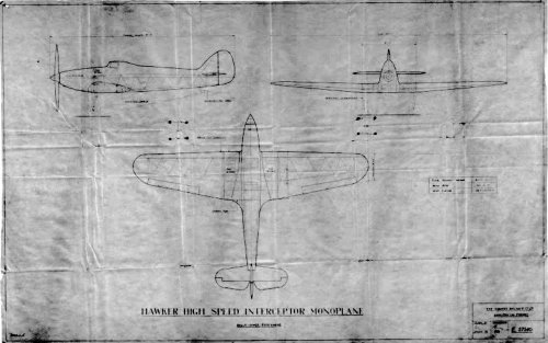

I have this image in my collection but cannot remember where I found it online. It is drawing E.57540 but clearly earlier than the version with the same number dated August 1934 which is included in Sydney Camm and the Hurricane which is the design that formed the basis for the F.36/34 spec. Does anyone knows the source or date of the drawing?

Looking at the ga. drawing (with a view to modelling), is that a wooden skinned wing ? or something more akin to early fabric covered Hurricane ?
cheers, Joe
cheers, Joe
The wing plan is very similar to that of the earliest Hurricane design, a little smaller and with slightly greater sweep on the trailing edge, so as structural design at Hawker during this period was progressive I would consider fabric covering to be the more likely.
Thanks Ralph, il go with a subtle fabric covering on the wings. As you say a structural progression from Fury to Hurricane
cheers, Joe
