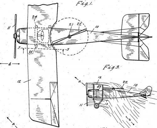

And Chris Matthews of San Pedro, California. See http://www.google.ca/patents/US1307826 for a slightly earlier variation on the Hall-Matthews theme.

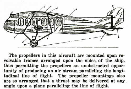

Anther one in 1928;
https://books.google.com.eg/books?id=rFmpUR9iLmAC&pg=PA125&dq=charles+S.+Hall+aircraft&hl=ar&sa=X&ved=0ahUKEwinsqyem5zSAhXHI8AKHdTMADAQ6AEIHDAA#v=onepage&q=charles%20S.%20Hall%20aircraft&f=false
