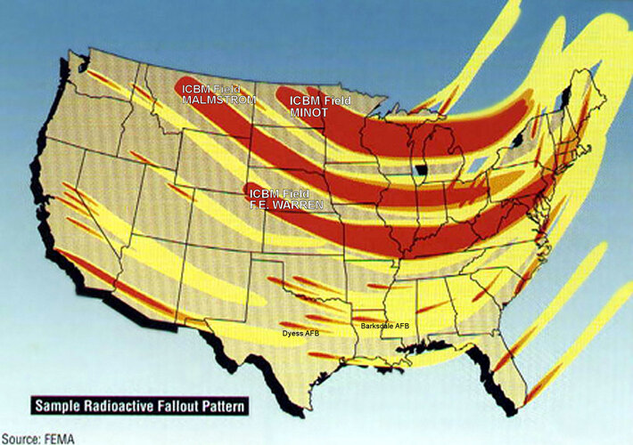

The silos are vulnerable argument always skips over the “needing 400-800 warheads landing inside CONUS” part. It would be much more likely an adversary would consider 2-10 warheads on a couple or three bomber bases and maybe a few dozen [conventional] Tsirkons at our Boomers in port.
Even if that leaves us a couple subs at sea what exactly do we do when the other side still with 1540 warheads left (and maybe China joins that side as well) to our 80-120 says stand down or we hit 1540 cities [I’m exaggerating for effect]
Now we’ve lost maybe only 50k-100k killed in the first scenario do we risk 100M-200M more just to strike back?
Why do we need to have 400-800 warheads land in CONUS? What point does that serve, other than provincialism to let the USAF maintain an ICBM force? The fallout from 400~ warheads landing on the ICBM force would be many times more lethal than the warheads themselves.
By contrast warheads on bomber bases would be much cleaner as the enemy only needs to aim for maximum radius of 5 PSI overpressure.
There are 14 x Ohio SSBNs, and if we use the 1/3 rule of thumb, that leaves us with 4 at sea at any one time. At 24 missiles per boat, that's 96 SLBM, and if we ignore New START and reload them to their full throwweight of 14 x RVs, that's 1,344 nukes we can throw back.
That doesn't also count that there would be a few more SSBN that would be in port or returning/transiting to their operational areas fully loaded and they'd be capable of firing their missiles either pierside or from where they are now. At 336 warheads per SSBN, that's a bunch more we can add to the tally.

Something I think you are missing sight of here is that silo basing isn't about protecting the population of a country -- the population play the role of expendable bystanders who must die to protect the missiles.
See attached photo.
