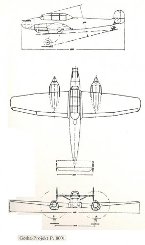

Hi Peter,
It might be helpful, closest, related project Go P.8-01 (8001) zerstorer,
The three major differences: two seat, two fin the tail and the small difference in sizes (sizes are referred to in your source).
Otherwise, the overall geometry and the appointment of the same.
Anatoly
from H.J.Nowarra "Die Deutsche Luftrustung 1933-45" Vol.2
Chesc Borovik
Many thanks for pointing me in the right direction.
And it will help me a lot, as I intend doing the P8 too.
Appreciate it.

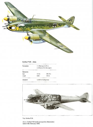

Hi Flitzer,
i found this in the book "Luftwaffe Secret Projects:Ground Attack & Special Purpose Aircraft".

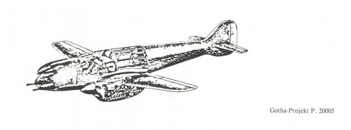

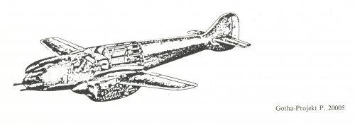

I found in H.J.Nowarra "Die Deutsche Luftrustung 1933-45" Vol.2 a different name of the project - P.20005!

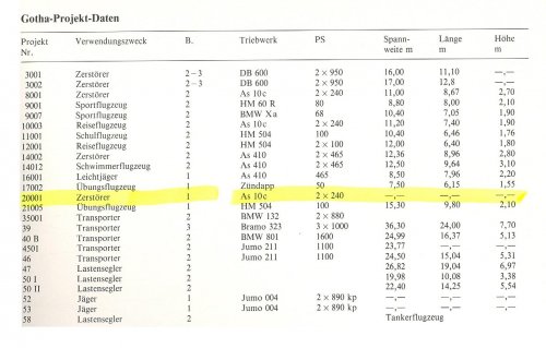

Go P. 20005 found at page 152.
On page 147 is a list of Gotha project data - there is a different number 20001.
Sorry nothing best :-\

Unfortunately I did not find any more or different info about the Go P20 in my local library and at the University. :-\
Many thanks fightingirish.
Appreciate your time and effort.
