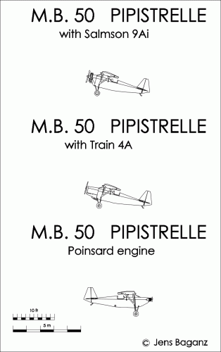

Examples of aircraft fitted with Train engines :
- Brochet M.50 Pipistrelle (type with 40hp)
- MS.560 (train 6Do-1 with 75hp)
- MS.660 (Train 4E-1 with 40hp)
- SECAT S4.75T (train 6D 03
- Druine Aigle 777 (Train 4T with 40hp)
Seems not, that great numbers were produced, at least not for aircraft, mainly
used for prototypes and one-offs.

The Brochet MB.50 was built in quite a number of examples, at least one of
them with a Train engine, more often with the Salmson, as you've mentioned.
And the MS.570 had a Renault engine, that's right, but it wasn't the MS.560 ... ;)
