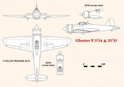

Gloster F.35/35 revamped from Mercury to Bristol Taurus. source: RALPH PEGRAM «Folland's Forgotten Monoplanes. Part 2: Diversification and Disillusionment »« The Aviation Historian »10, via the Russian language website "Alternate History, "http://alternathistory.com/zabytye-monoplany-genri-follanda-chast-6-vozvrashchenie-k-istrebitelyam. Apologies.
This is taken from my article in The Aviation Historian and the 35/35 aircraft is not just a re-engine version of the F5/34 fighter
