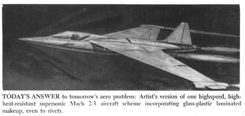

This Glass-Plastic future hypothetical fighter designed by Thomas E. Piper who was
the director of materials and process engineering for Northrop.

Pre-, pre-, pre-carbon fiber. Cool! -SP
Presumably this is just an obsolete way of referring to fiberglass. Components fr boats and cars and airplanes were made circa 1940, though the resins used were apparently not very good at that stage. By 1952 I imagine the chemistry of proper epoxies for fiberglass had improved enough for aircraft manufacturers to consider using the stuff. By the 1960's they had moved past glass to boron fibers, and then to carbon fiber.
