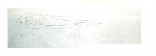

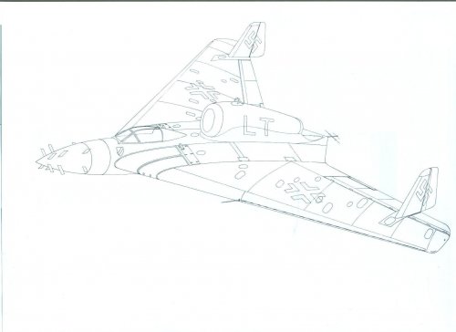

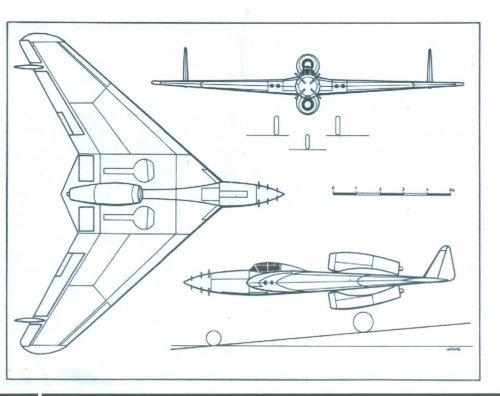

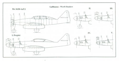

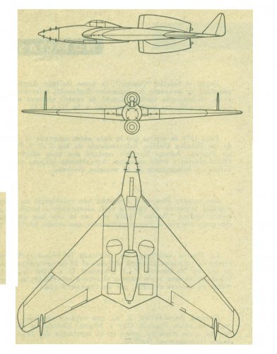

I can't recall the project in images B, C and D... can you give me its designation?

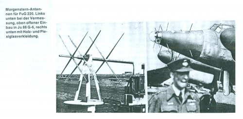

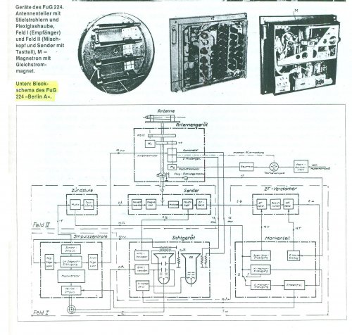

Thanks Justo, these are very interesting documents. There seems to be a typo regarding the radars - there was no FuG 224 "Berlin A"; it was the FuG 240; and the "Berlin A" did not have a Morgenstern antenna but a parabolic dish for its 9 cm wavelength.
Sorry, my mistake. The FuG 224 "Berlin A" was indeed the first German airborne radar with a wavelength of 9cm and used four "keramische Stielstrahler" (ceramic sticks of slightly conic form) as antenna. However it was not a night fighter radar but a surface surveillance radar like the British H2S from which it was derived.

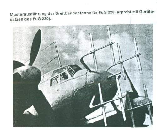

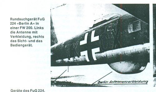

The pdf contains an FuG 224 image on page 25, caption:
4-element polyrod antenna, downwardlooking & rotating at 400 rpm.
That, combined with Justo's radome picture, should settle the question whether FuG 224 was a belly-mounted air-to-ground or nose-mounted intercept radar.

As we are already very "off-topic" - has anyone got any information about the "Kanzelringantenne" (~ cockpit ring antenna) for the night fighter radar FuG 218? Fritz Trenkle mentions it in the book "Die deutschen Funkmessverfahren bis 1945" (Justo showed it as source above). It is described as an antenna for the night fighter variant of the Me-262 using the FuG 218 or later the FuG 219; the antenna consisted of metal foil segments which were internally bonded to the front section of the aircraft structure behind a radome.
