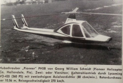

Built by Georg William Schmidt (Pioneer Helicopter Co. /Florida) around 1962/63:
Cold cycle two to four seat helicopter, 1 Lycoming VO-435 with 260 hp, driving a two
spool axial compressor, rotor diameter 10.06 m, cruising speed 270 km/h
From "Der Flieger", October 1963
Not mentioned, maybe with puffer jets in the tail booms ?

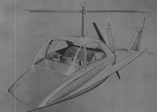

Very interesting. I don't have any proof toward this, but my assumption is that this prototype might have started life under Cessna, when they were still making helicopters (they stopped in 1962 I think). What caught my attention is the position of the engine (typical in Cessna helos) and the tail arrangement, which is reminiscent of a Cessna concept published in 1961. Also the designation follows nicely the CH-4 (last known Cessna helicopter project).
Yes, I thought of it, too (we had it here http://www.secretprojects.co.uk/forum/index.php/topic,2672.msg21527.html#msg21527),
but honestly I was never quite sure, how serious this drawing was. I'm still not convinced, that the prop
would pass between the booms and took it just as a design study and never thought, that metal was actually
cut. But you may be right about a relation, at least as a kind of pattern.
The fact that this drawing is from Cessna is not questionable, but to me it's merely the work of a designer with little consideration for the technical aspect of things. The PH5 looks pretty much like wat a proper engineer would have come to starting with that drawing.

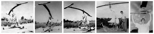

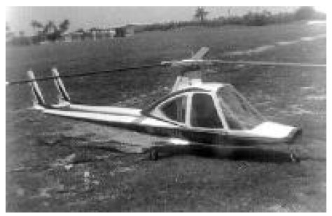

Been doing some more digging and this is what I found:
George William Schmidt set up the Pioneer Helicopter Co. in the early 1950s, based in Hallandale, Florida.
Their earliest known product was a 1953 experimental tip-jet microlight helicopter called the Paracopter-2, apparently powered by an Argus engine.
Ten years later, they produced the PH-5B Pioneerhelicopter.
I'm enclosing a set of pictures for the Paracopter-2, as well as a different photo of the PH-5B.
