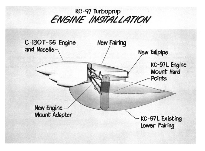

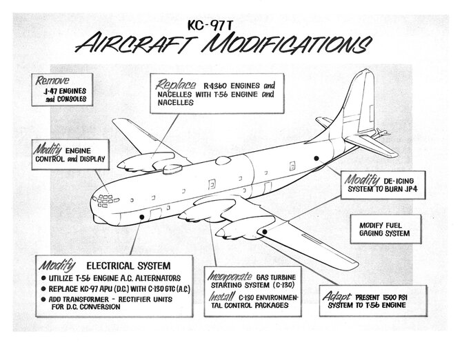

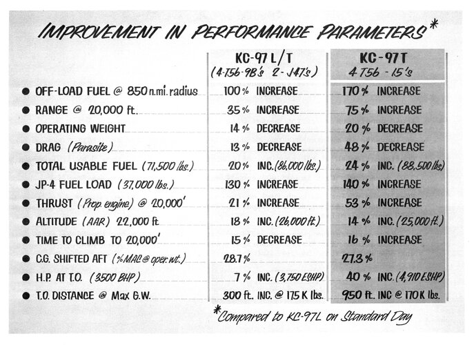

Came across this proposal dated March 23, 1972 in the late Dick Atkins collection. Appears to be an unsolicited proposal - interesting use of bits and pieces to make for a more effective aircraft, at least on paper.
  • zGeneral Dynamics Proposal KC-97T Improvement in Performance Parameters 2.jpg
  • zGeneral Dynamics Proposal KC-97T Improvement in Performance Parameters.jpg

T56 engines were integrated with Boeing 367/377 airframe as part of the Mini Guppy Turbo and Super Guppy Turbo conversions.

I can't help thinking... that thing has C-130 DNA all over the place: engines, wings, APU...
