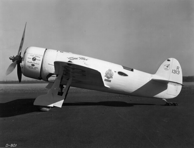

There are several photos of the HM-1 (NR1313/NX2491) on the San Diego Air & Space Museum (SDASM) Flickr photostream, including after its modification (link).
Here are a couple of examples, including a photo with Frank Hawks.
http://www.flickr.com/photos/sdasmarchives/8477421262/
http://www.flickr.com/photos/sdasmarchives/8477420804/

Hesham, Time Flies is a well known race/recordplane designed by Howell Miller of Gee Bee fame,
it is considered the final realization of the Gee Bee formula.
Hawks had planned to use it for various record attempts, but little came of it, and after a landing
accident it sat unused until rebuilt with a conventional two-place cockpit in an attempt to sell the
design as a fighter, without success.

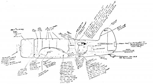

Is there anyone who can decypher the tekst written on the sideview drawing.
There's noting I found in the concerning tekst about a 'stratosphere fight'..?

My dear Lark,
that's the best larger view,but still can't read it.

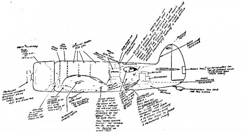

Hi! I can read follwing leters.
Pratt & Whitney Twin Wasp 1150HP at sea Level, Fire Wall, Oil Tank 25GAL, Gasoline Tanks 230GAL, Radio Receiving Antenna, Battery, Dynamotor, Radder Tab, Radio Transmitting Antenna, Oxygen Bottles, Entrance Door to Pilot Cabin, Wheels...Gyro Pilot...Propeller...Retractable Landing Lights...
I can't find pressurized cabin, turbocharegr or mechanical drive compressor for stratosphere flight in this side view drawing.

blackkite's drawing clarified a little more:
The Twin-Wasp had a built-in mechanical supercharger and according to P&W charts on the AEHS site, the Twin-Wasp BG
was equivalent to an R1830-7 and had a supercharger ratio of 11.94:1.
http://www.enginehistory.org/P&W/R-1830/R-1830Index.pdf
