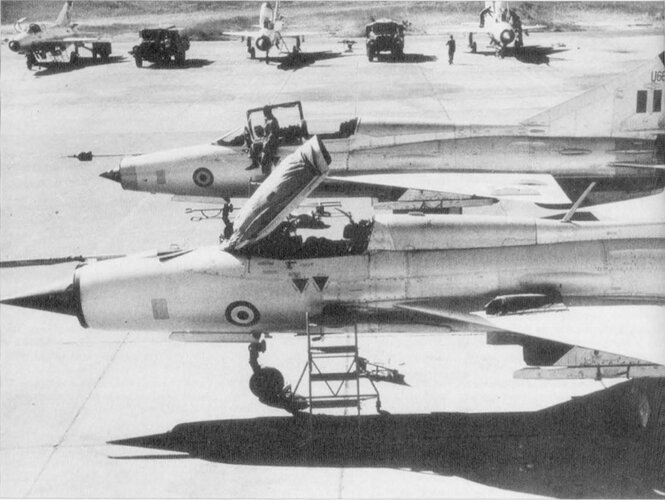

Frameless canopies weren't always such a success. See the MiG-21 which reverted to framed.
@Zoo Tycoon; I believe the F-16 canopy is specially made to remove optical distortions when complete, something about tailoring the thickness of the flat sheet before it's stretched and formed to shape . . .
@dan_inbox; Even the one piece MiG-21 canopy had a separate, flat windshield.
Image crop from source image HERE :-
cheers,
Robin.

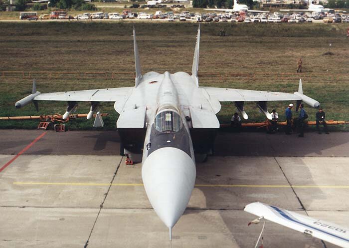

You both raised interesting points that jogged my memory on the original updated Mig-31.
The Mig-31M interceptor first flew in 1985, and had a new frameless windscreen as part of a deep modernisation. Clearly, MiG at least thought it a worthwhile feature in the interceptor role.
The end of the Cold War put an end to it obviously.
Pity..it was a beautiful, absolute beast of a plane.

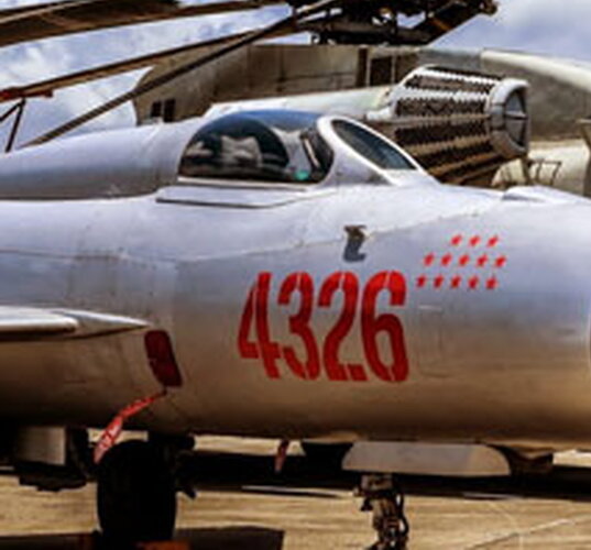

A secondary function of Mig-21's canopy is that it folds down in front of the pilot during ejection. Then the canopy protects the pilot against arm, flail, shrapnel in the face, leg flail, etc. at supersonic speeds.
Folds up I think, rather than down?
I was under the impression it is hinged at the front, thus pivoting upwards and acting to screen the pilot from the slipstream.
It's cleverer than that . . .
When the canopy is closed, the side rails of the canopy are attached to pivots on the seat. On ejection, the forward canopy hinge is released, and the seat, with the canopy attached, departs the aircraft. As this happens, the canopy pivots nose end down, to form a shield, protecting the pilot. once the seat has cleared the aircraft, the canopy is jettisoned, prior to pilot/seat separation.
From Wiki :-
"On variants prior to the MiG-21PFM, the cabin canopy is hinged at the front. When ejecting, the SK-1 ejection seat connects with the canopy to make a capsule that encloses the pilot. The capsule protects the pilot from the high-speed airflow encountered during high-speed ejections. After ejection, the capsule opens to allow the pilot to parachute to the ground. However, ejecting at low altitudes can cause the canopy to take too long to separate, sometimes resulting in pilot death. The minimum height for ejection in level flight was 110 m. Starting from the MiG-21PFM, the canopy is hinged on the right side of the cockpit."
cheers,
Robin.
