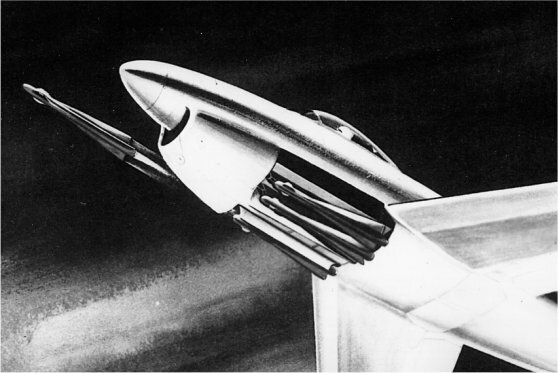

Then in March 1952, NAA submitted a further study to AMC, which it continued to refine until August of that year when a less radical proposal for “MX-904 Falcon Missile and 2.75” FFAR Rocket Installation in F-86D Airplane” was proffered. This proposal was for a new-production version of the F-86D with four Falcon missiles replacing the internal Mighty Mouse complement of the standard F-86D and up to 24 of the unguided rockets now in wing packages or various other combinations. An extended ‘wet’ wing leading edge was also proposed, which would carry fuel and offset deletion of external drop tanks. A Hughes E-9A fire control system was a key component of the new F-86D proposal.

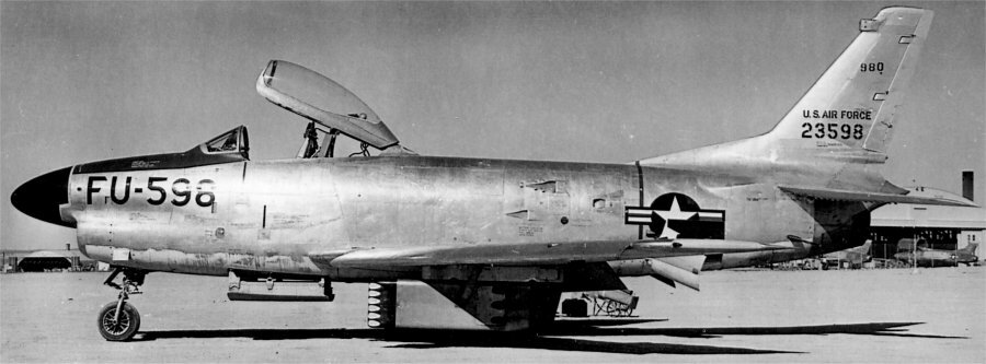

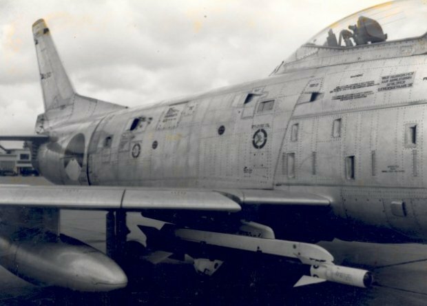

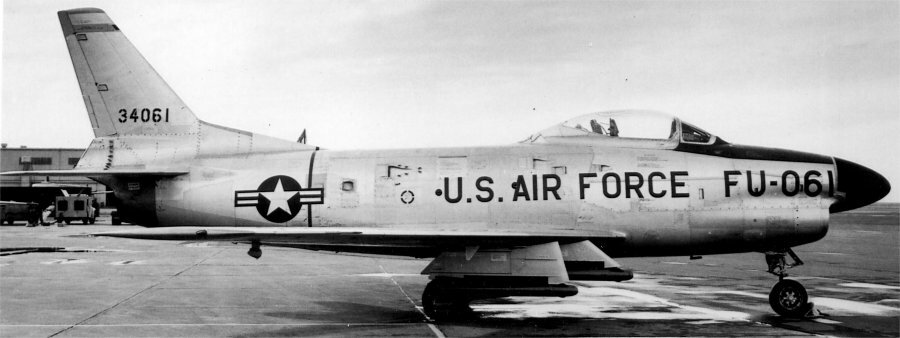

NAA did however test the external Mighty Mouse rocket packages on s/n 52-3598 (the first F-86D-40 airframe) and the Falcons (externally) on F-86D-60 s/n 53-4061, the latter with the extended-chord wing later installed on F-86L interceptors.

Holy packaging headache Batman!
Both the engine intake trunk and the missiles are mounted UNDER the cockpit.
Talk about cramped quarters!
Wow, awesome find on the ‘Advanced F-86D Transonic Interceptor' Sabrejet!!
I'm wondering how the rocket exhaust gas ingestion into the main intake from the Aim-4’s might have effected the performance and safety of the turbojet?
Sadly the four external underwing Aim-4 Falcon arrangement seemed to have made so much sense.
Now for the era, surly NAA would have built a beautiful scaled table top model to support their proposal the the USAF!
Hopefully more drawings might come out of this.
Regards
Pioneer
Bear in mind that the Falcons wouldn't have taken up much more space than the Mighty Mouse rocket pack. Also NAA was already looking into revised forward fuselage contours.
