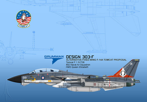

To make up for the grinchy remarks above, I should add that I have numerous Tomcats in my toy and model collection. I also do get the appeal of Brit versions.
