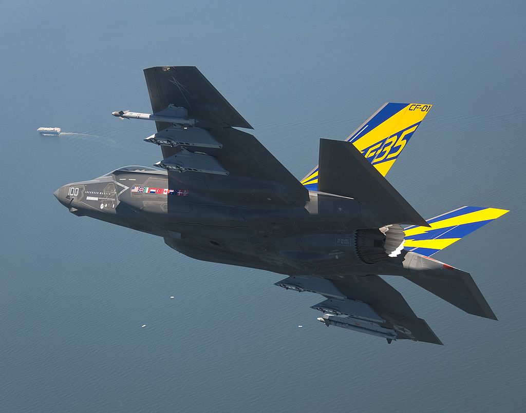

OK, I get that the B has the VTOL ability but as far as the rest of the aircraft goes, can anyone tell me the differences? I saw a linked article on this forum about the super hornet and mention was made that the F-35 C cannot carry missiles on the wings. Is this so and does it matter if they manage to fit 6 missiles internally?
Utter garbage.

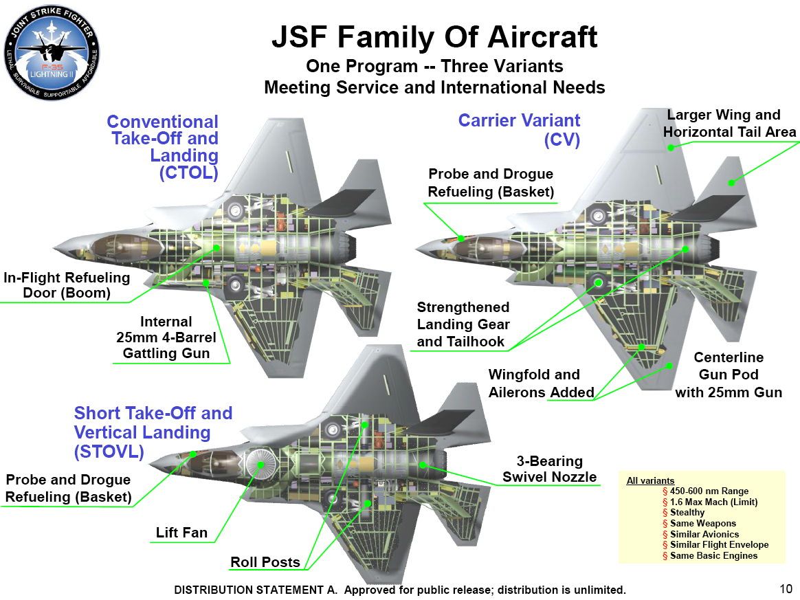

This old graphic is still useful too:
Why the longer landing gear on the 'C? For great shock absorbing on landing?
Where do you get the idea that it's longer? The graphic states that it's stronger; the F-35C has a double-wheeled nose gear as well.

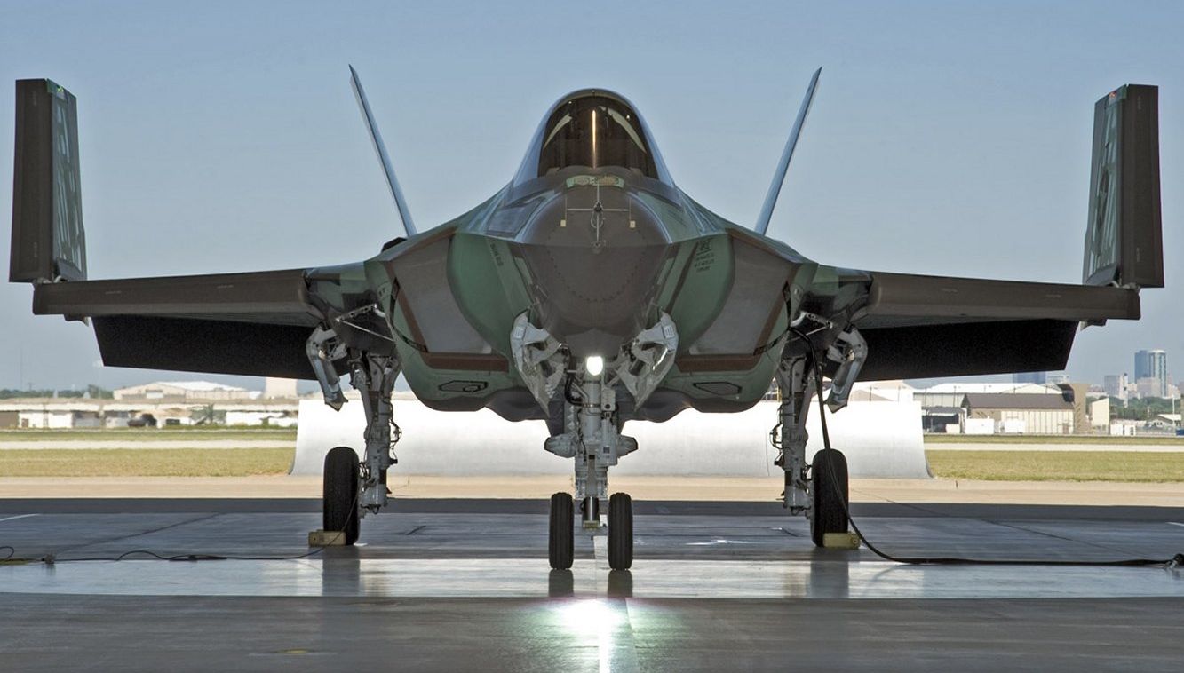

On the ground the difference is negligible or non-existent:
A:
C:

Kadija_Man said:
OK, my mistake. Why the need to strengthen the gear?
Because it's landing on a carrier.
