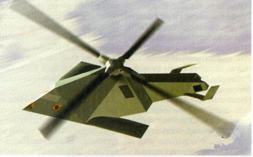

Found that pic credited to Boeing in 1988 Koku-Fan issue - with B-2 roll-out and F-117 unveiling as a main theme
Another speculation? May be our Japanese friends can help with translation?

I doubt that it has anything in common with the real things. I really can't see the way, how to solve the radar reflections between this type of rotor and the rest of the fuselage. Not to mention the air intakes for cruise engines (?) and the lot of other details. For me it is fan art, nothing more. At least for now.
OK, I'm not naive, just sent it to share, being surprised by picture credit. If you judge of anime, you can come to the conclusion that Japanese guys really don't need any artifical substancies to expose their fantazy. Koku Fan artists had some weird ideas from time to time - I remember seing schematics of YF-23 weapon bay with pallete rotating along aircraft CL to move missiles in the airstream...

Hardly doubt that UCAR has roots in 1988 Koku-Fan)))
flateric, my old friend,
Checked with a Japanese friend of mine and the caption says, 'CAS-X Concept Drawing released by Boeing Inc.' Question now is what is CAS-X? Close-Air Support - eXperimental?

Timing is right.

CAS-X is also mentioned in a 1988 GE AIAA article on propfans, with a tiny picture of a concept. Therefore CAS-X embraced very different concepts.
