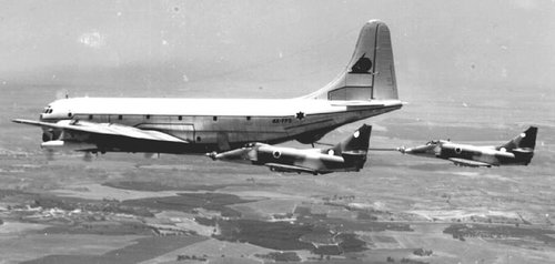

Weren't the Israeli aircraft C-97s, I mean transports ? Later converted in tankers, admittedly.
uk 75
Sep 27, 2006
3,816
2,862
Surely the best analogue to the Luftwaffe would be the Canadians at Lahr who used the Starfighter in West Germany and in a similar variety of roles.
dan_inbox
Sep 3, 2006
992
577
Several were, but apparently not all. The one on the photo, 52-02627, was born as a KC-97G-24-BO straight from momma Bouingue's womb.
So says this list: http://www.worldmilitair.com/serials/countries/usa/uni 040 1152.pdf
Now, it may have been de-mil'd before making aliyah, and then re-mil'd over here. Would'nt make much sense, but stranger things have happened in IDF procurement.
SSgtC
Jul 13, 2020
761
1,309
It could also have been "officially" converted to a C-97 before being sold to Israel while in actuality, it still retained it's refueling equipment
