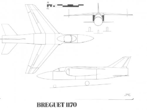

Other proposal was from Breguet (Br.1170)

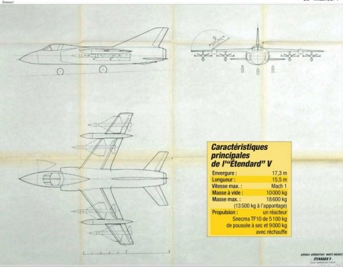

In September 2011 issue of the French magazine "Le Fana de l'Aviation", there is an article about the American F-6D Missileer program and about the French TALP (Tactique á longue portée)program. The article shows a 3-view drawing of Etendard V with 2 unknown missiles under each wing.
Tinwing, the wing folds are outboard of the tanks.
zen
Jul 15, 2007
3,191
1,950
missiles looks curious, perhaps a ramjet is the part hanging beneath the main missile body?
