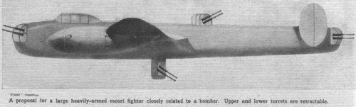

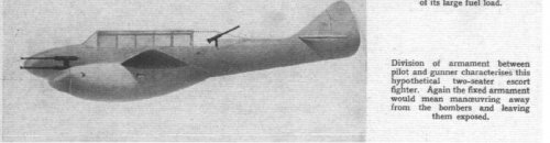

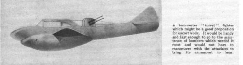

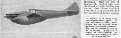

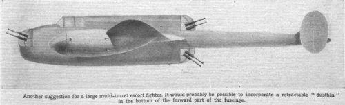

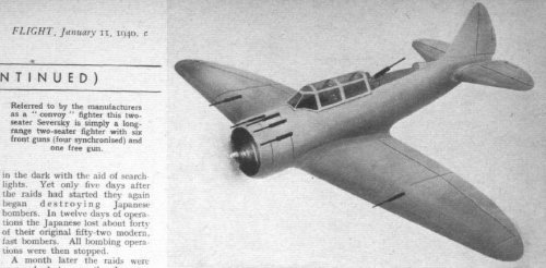

from Flightglobal a suggesting for escort fighter projects.
http://www.flightglobal.com/pdfarchive/view/1940/1940%20-%200080.html
http://www.flightglobal.com/pdfarchive/view/1940/1940%20-%200081.html

I always liked the escort fighter idea. Thanks for the pictures.
I believe that its real heyday was during world war one, when fighters didn't carry cannons and a bomber could survive to fighter for a sufficient period of time. Fast two-seaters were regularly used as escorts and there were several prototypes of large multi-turreted fighters. I suppose the YB-40 would classify as one of the last escort fighters?
