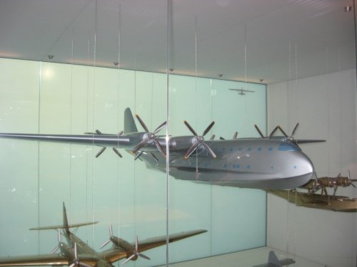

Hi!
Do-214 picture from Dornier museum

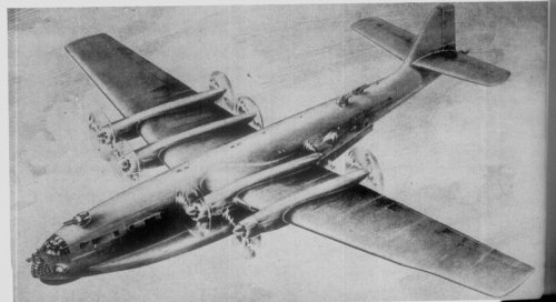

An artists impression of the military version of the Do P.214
from Fred Gütschow "Die Deutschen Flugboote".

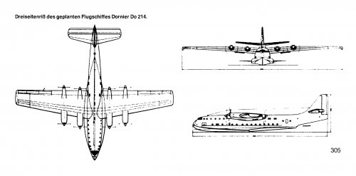

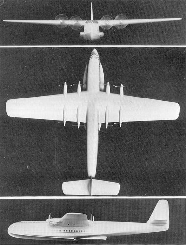

A 3-view of the civil version of the Do 214 from Fred Gütschow "Die deutschen Flugboote".
From all I know, the military use of the Do 214 and the use as a transport for rare resources
was more or less an attempt to rescue this project, which otherwise would have been axed because
of "not needed for the war effort".

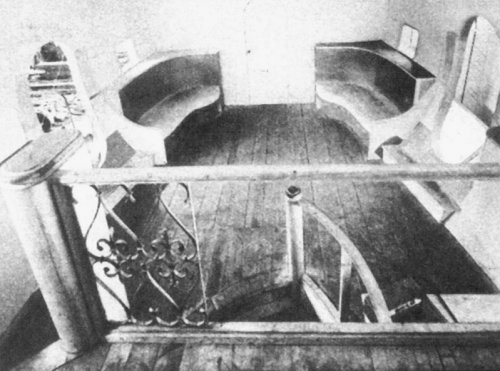

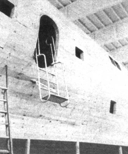

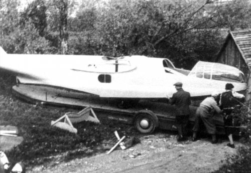

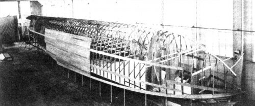

I'm attaching a painting of the Do 214, a few photos of the full-size wooden mock-up and sketches of the planned interior decoration.

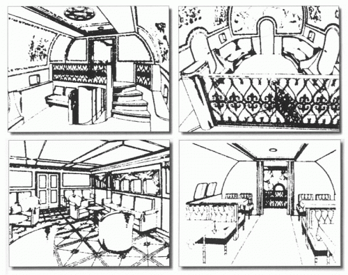

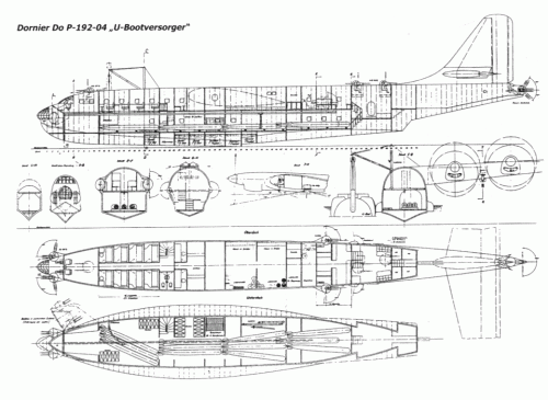

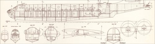

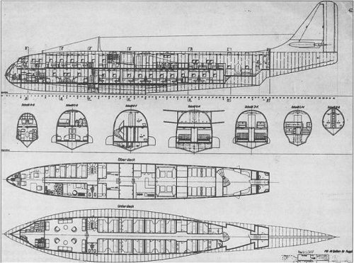

Three more pictures:
  • A version of the painting posted above, this time in military guise (no specific variant)
  • A cutaway plan of the P.192-04 "submarine supplier" variant

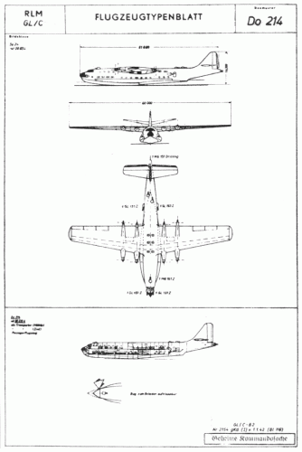

  • The official RLM reference file for the Do 214 with three-view arrangement and cutaway profile view

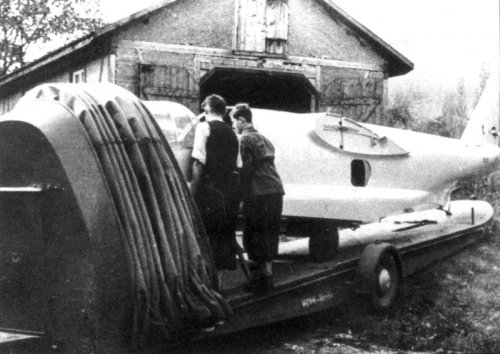

Also note that the Göppingen Gö 8 glider was conceived as a flying test-bed for the planned Do 214:

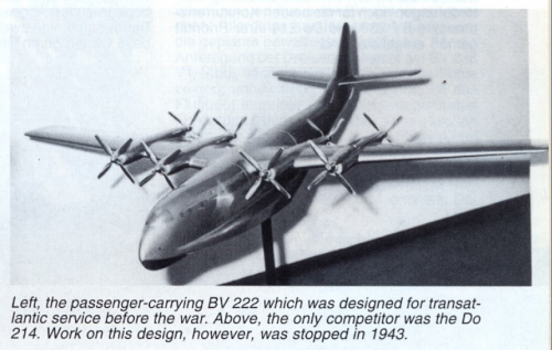

From Jet & Prop 1/1998,
here is a good shot to Dornier Do.214 Model.

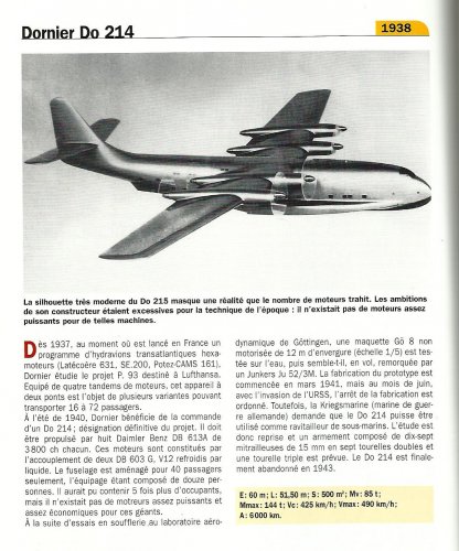

Hi all
From the "Mini docavia" editions Lariviere

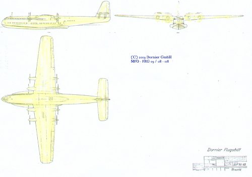

Hi! Do214's base Do p.93-10.
http://www.do214.mega-forschung.org/index.html
